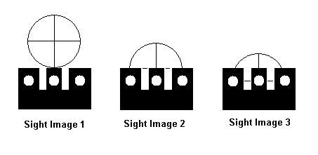

Different weight bullets will affect POA (point of aim) generally heavier bullets
hit higher but just a diiferent brand may change of POA.  Here are some
questions you need to answer:
1. At what distance are you getting these groups.
2. What is the highth measurement of front sight ? a taller sight will
help with your problem.
3. How are you holding sight picture ? Most gun maufactures set up guns
using #1

I am shooting at 25 yards.  I am using sight picture number one.  My front sight measures 1/4 inch tall.  With the factory rear sight it was 2 to 4 inches high.  With the millet rear sight it is 10 to 12 inches high.  I did not measure how high it is hitting that is just how it looks.  I know that millet makes a taller front sight, but they are no longer manufacured.  I was hoping someone here knew where there was old stock available.  As for pictures, I have never posted pictures before.  Just haven't taken the time to learn how.
