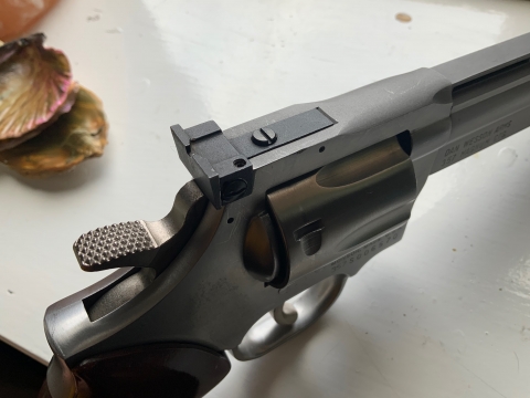

On top of my rear sight there is a hole or a little screw. Do i need to loosen it when adjusting the sight ?  Greetings from Holland.

I believe it is a screw for the purpose of retaining the spring and small steel ball that together acts as a check on the adjustment of the windage. No need to adjust it when adjusting the sight. It's only meant to keep the windage setting from wandering off the desired setting. If not then someone on the forum will set me straight!big-grin
