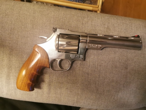

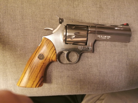

Hi.
I have a problem with the triggerpull. I recently bought a mod 744 (i think) with 6 inch vented and a 4 inch VH barrel, serial nr SB007191. Anyone know wich year it is made? In Norway the triggerpull should be 1360 grams (about 3 pounds) in competitions, but mine is around 900 grams (2 pounds). Is there any way to adjust this, or should i get a new spring? (wich spring) Not very easy to buy parts to DW's in Norway, because you can't get gunparts out of USA!!!?

15828447237062745800904244085877.jpgImage Enlarger
1582844962204879235829253384382.jpgImage Enlarger
