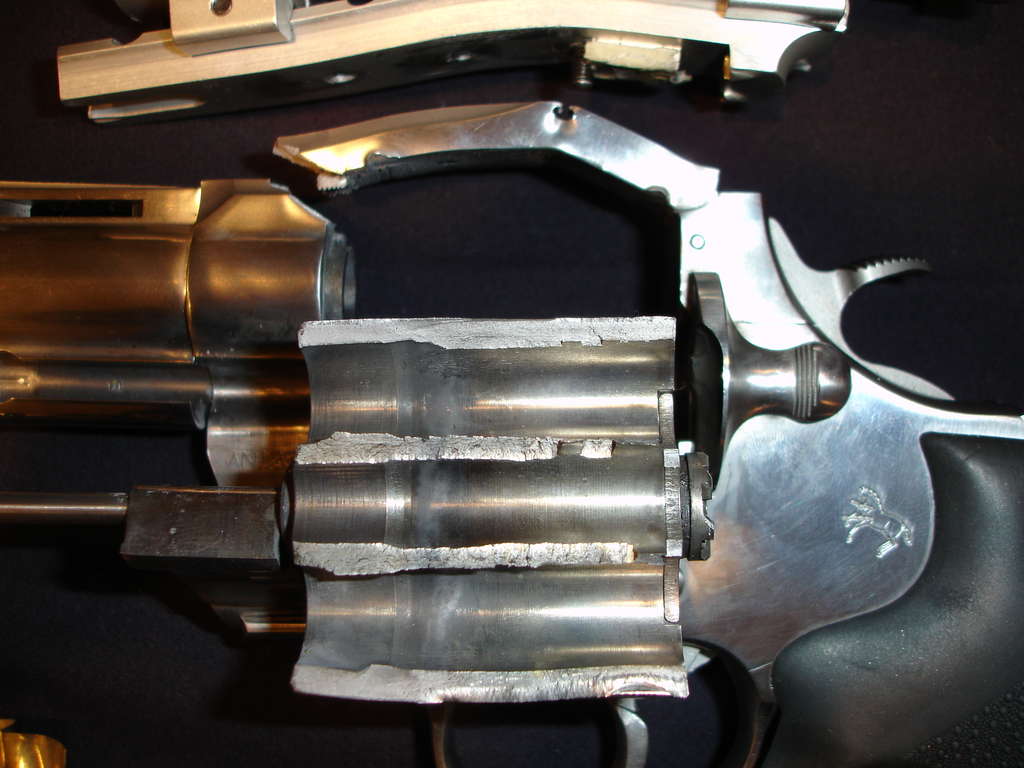

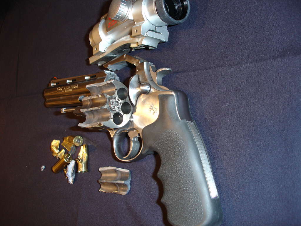

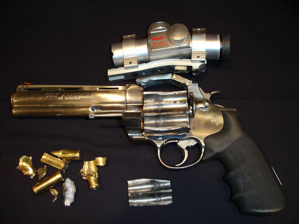

Let me find some pics–I have some of a scoped revolver that blew up–WOW!

October 21, 2009 - 11:21 pm
Look at that, an Anaconda!rofl  Although my friend's blow-up wasn't as bad as that one, it did split the top strap just above the barrel.
