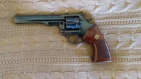

Hey Guys … just bought a Model 22 yesterday.
Its been loved pretty well LOL … and has some Barney , but I am stoked to find one locally.
My issue is the cylinder locks up and stays locked if I go to spin it to the right … but it just takes a small amount of pressure to get the cylinder to spin to the left without my hand on anything else but the cylinder.
I think I read on here another guy had multiple revolvers that were acting the same way … is this something I need to be worried about?
Thanks for the help/advice!  🙂 ---

BTW, you probably need a new bolt spring or hand spring. Probably the former but get a small spring kit and change them all. Read the "Average Joe Tuneup" in Gunsmithing.

Thanks for all the info Ole Dog … I'll start searching for a spring kit and do the Average Joe Tuneup 🙂 ---

I think Eric at EWK arms has kits
