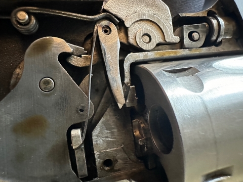

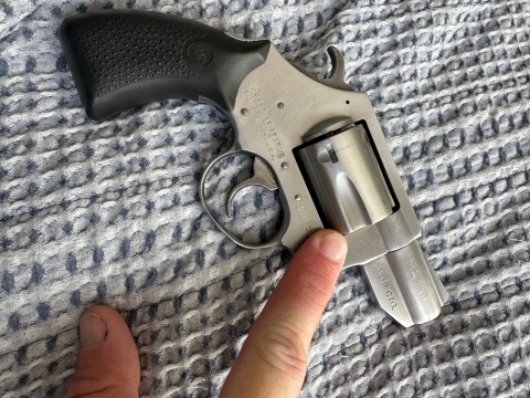

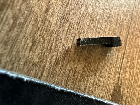

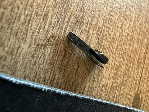

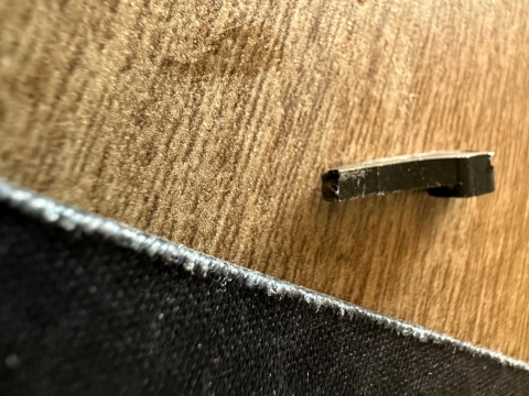

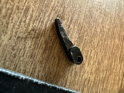

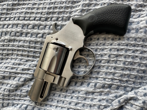

I recently picked up a lil Dan or 738p at auction with a broken hand. I had no idea how rare these are and even more importantly of their unique guts. I fits my hand well and has some nice weight to it. I’d like to get it running reasonably. I’m open to suggestions.

Lots of luck, you will need it. Perhaps a talented Smith could make you one. This is certainly the right place to inquire though. Can you post a picture of the hand? A member may have one and not realize what it is.

I’m working from an iPhone and can’t figure out how to post it. It’s a pretty fine part. This one is most likely a wall hanger.

You'll most likely have to have a gunsmith make you a new one.

Maybe a small frame hand can be modified. It would have to be heat treated afterwards.

I reached out to Eric Wesson hoping he had some parts lying around but he said he had nothing for the lol Dan. Sorry looks like your going to have to have one made. They were already pretty rare guns so any parts for them would be hard to come by! Hope it was cheap! If you end out parting it out I will buy the grip from you!

I'm wondering if one could be made from a small frame hand ...

As the trigger is pulled, the hand spring engages the hand and pushes the hand against the rachet(star) to turn the cylinder. All small frame Dan Wessons have the same size cylinder, rachet and hand. The only difference is the chambers in the cylinder. So, 22LR, 22 Mag, 32 mag and 357/38 Special all use the same hand. A Lil Dan is a different size frame and cylinder. The hand is unique to the model.

Lil Dan is a 5 shot 38 Special from  Wesson Firearms made at the Palmer factory circa 1991 to 1995. Steel, fixed sight conceal carry gun. Similar to a Ruger SP101 but lighter and a bit smaller. They have a removable barrel but no other barrel lengths were ever sold. That is a shame in my opinion. The choice of longer barrels may have made it more unique.
