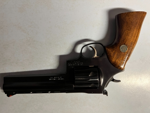

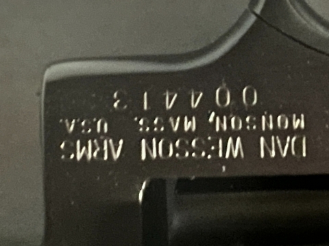

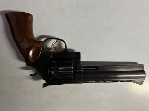

Growing up as a child my parents were gun collectors. A couple of decades ago they lost interest and slowly sold nearly everything. I recall them having a few DW examples but one gun they held on to was a DW .44 with several barrels with the tool and buckle. They have recently started handing the guns down to me as I've started collecting myself. A few months ago the passed the .44 down to me an I discovered that 6 years ago it was involved in an areal flood in their home. To make matters worse, it was in a foam-padded case and they never realized it. It looked like it was in a shipwreck found by divers. I had a gunsmith reblue it and the barrels to match. I got it back and it looks factory-perfect. However the barrels were for a .357 that they sold off years ago. FML. So now I have a .44 with no barrels and (3) .357 barrels with no gun. Is it worth it for me to get a .357 for the barrels and barrels for the .44? I've attached some pics of the .44 after reblueing if anyone can help with model ID.

First, welcome to the DWF!!
Based upon the documentation here on DWF on serial numbers and manufacture dates (https://www.danwessonforum.com/wp-content/files/DanWessonSerialNumbers.pdf), it looks like your 44 was likely born 1981.
In reply to your questions, I think you’ll find the advice of most DW fans is buy-now.

You have one of the first 10,000 Model 44 DW's. They have a shorter hammer spur than later guns. That is the only difference. The 44 Pack had 6 and 8 inch barrels with 2 barrel tubes for each length. One tube had ports that really don't work well. They came in a factory brown suitcase case with tool, 2 grips and other accessories. Some folk would add the 4 and 10" Barrel assemblies. My advice is to be happy with the gun you have until you know more about values. Do you have a tool. It is necessary. If the Styrofoam box is nor destroyed it is a plus. I would look for a 357 in fine condition with a barrel length you don't have and with the style shroud you do have. As far as assembling a pack, again, learn more about what to get and the values.

If you are collecting and also shooting, I would say to keep what you have and yes - find a .44 barrel and shroud (plus the barrel tool) and also find a .357 frame to enjoy shooting those barrels you do have.  These are great shooting revolvers and their value is climbing
