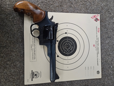

Why the cold shoulder for W12's??????  Mine shoots lights out!!!
