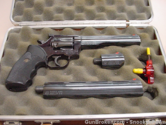

Maybe we should have a barney comparison/contest someday Laugh…  I don't have any real bad ones anymore–I did have one that was literally purple.
I just bought this one this afternoon on GB, and I think it has a little Barney going on...
Dang Shoot don't buy'em all!  I gotta stock my 401dw too!  Cool Pics
December 16, 2010 - 9:05 am
Big GrinBig GrinBig Grin .... And I found this one last night -- seller contacted me direct...  This one looks a little better as far as barney goes.
