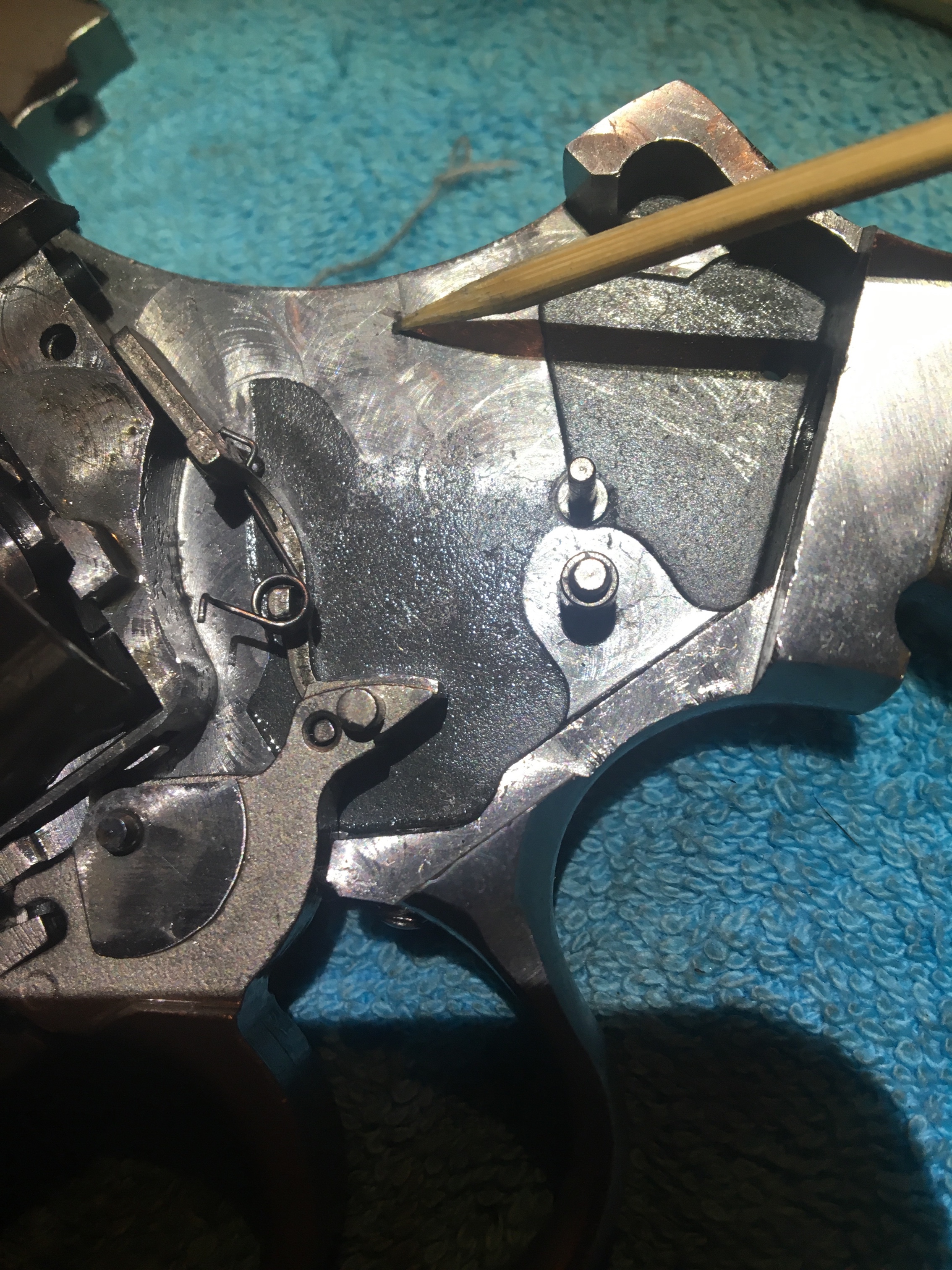

December 5, 2016 - 4:30 pm
image.jpgImage Enlarger
I've had the same problem whit my 715fb but now it works just fine, I polished the surface that the hammer slides against realy carfuly with 1200grit dimond flat and put a little hoppes oil on the surfaces. But duble action is way to havy on this gun to be able to shoot accurately and fast unfortunately.
but single action is super sweet.
regards from Sweden
