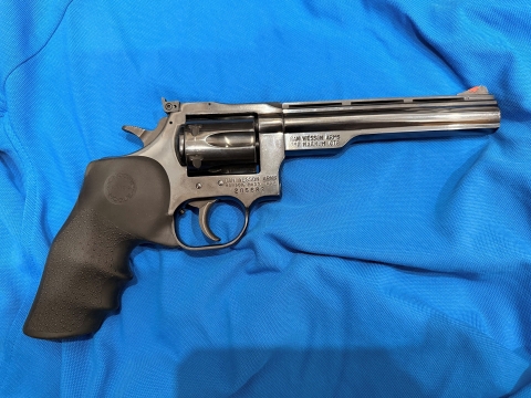

Hello fellow Dan Wesson enthusiasts. I picked up a used Dan Wesson .357 about 12 or 13 years ago, and I am sad to say I never looked into what model or age it was. I have a database for my collection and I am updating it so it got me thinking about the model and year on this one. Can anyone tell me what I have here? Serial number is 205683. Thank you all in advance! PS, not sure I love the Hogue grip 🤣

Thank you sir. I do believe, based on some pictures I found, that I have a model 14-2. I'll be very curious about the date. 🙂 Sorry, I thought I added a photo but I must not have uploaded first.

Looks like a 15-2 to me.

Yep, I agree it's a 15-2. I didn't pay attention to the ribbed barrel. Thanks man, I love that thing. Just picked up a 1954 S&W Pre-Model 10 today! It is gorgeous!

Anyone able to put a date on mine? Serial number 205683.
July 2, 2026 - 11:48 am
The model is not determined by the barrel shroud style.
The Model 14 is a carry / service pistol with a fixed, non-adjustable rear sight.
The Model 15 is a target pistol with an adjustable rear sight.
Both models can have the four styles of shroud installed; Standard (no vented rib or full length underlug), Vented (V nomenclature with vented rib and no underlug), Heavy (H no vents but full length underlug) or Vented Heavy (VH with vents and underlug).

Ahh, thank you for the clarification. Shows how little I know about the brand. I thought the 15 had the ribbed barrel and the 14 did not. I understood DW had a great reputation for making quality wheel guns so I bought it on a whim, and I got it for a steal at a shop because I bought a two-for.

Based on what I found, this one was built around 1979. I'll go with that for my database.
July 5, 2026 - 5:26 pm
Yes, around 1979 would be correct. Stinger is correct about 14-2 being a fixed sight gun and 15-2 having an adjustable rear sight. From serial number 50,000 to 75,000 ,15-2s have a pinned front sight with no plastic colored insert. That is why LeonardC had his black front sight cut for a colored insert. After 75,000 15-2s have removable front sights held in by an Allen screw in the end of the muzzle . The different shrouds will all fit a 14 or 15 but as the 14-2 rear sight is fixed and low, a 15-2 shroud will not shoot to point of aim  as the front sight would be too tall.
