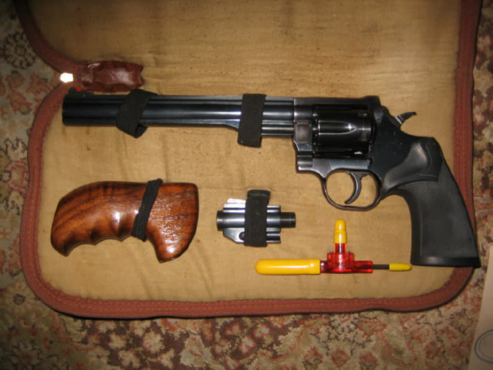

March 1, 2011 - 9:25 am
Blacktop said:
+1 on Steve's response. Sweet deal there occasion Did you change the sight
or is that a model 15 BA ? Don't see many 8 inchers on the 14's
That picture is from right after I got the gun.   The barrel is from a 15, I believe.  Since then I have gotten the conversion sight from EWK so that I can shoot .357s.  POI is about 3" to the left of POA at 20 yds, but elevation is dead nuts.
