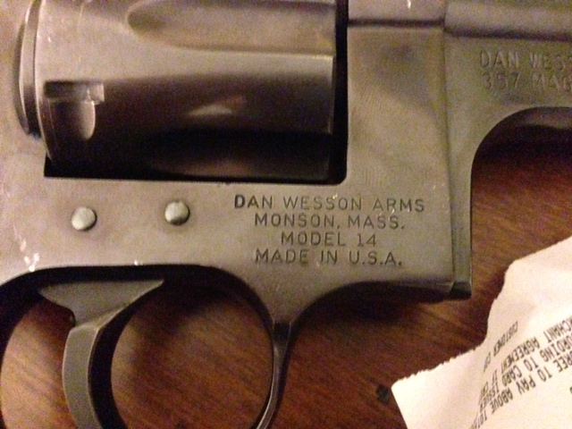

Just got back from purchasing my first DW 14.  The previous buyer didn't know much about it.  I'm just curious if anyone can point me in the direction of how old it is.  The serial number is 19265.  Also, can anyone recommend a good leather holster?  I'm not looking for something to conceal it I'm actually looking for something that will show it off!

That looks like a Model 14 from the early 1970's. A holster for a S&W K frame would be correct.

If you haven't had a chance to shoot it yet you are in for a pleasant surprise. The fixed sight guns can be extremely accurate and are heavy enough to gentle a 357 recoil. Please get a barrel tool and make sure the barrel assembly is on right. A .006 cylinder gap is the factory specs. but .003 on the proudest chamber will reduce spitting and imcrease bullet velocity. You should check all chambers to find the proudest. When you remove the shroud, keep in mind that the flange is what holds the cylinder crane on.Your gun was probably made in 1972. Also, barrel nut and grip screw, snug is tight enough. Especially if the grip screw is over tightened you could have problems with SA and light strikes. And welcome to the forum. Any problems , just Holler.

Great, well now I know the barrels for the 14 and 15 are interchangeable. My question is did the 14 come with a pack of various barrels?  If so were those barrels also in the porkchop style?  A guy is selling some barrels in NC and I'm tempted to get them just for giggles (I really like barrel it currently has.) The problem is they aren't in the porkchop style.

You need to get pork chop barrels for your gun. Yours is a first model 14. The non pork chop are 14-2 and 15-2. Enjoy!

That may be one of the fastest cases of DWAS on record!!! Barrel lengths of a model14 and 15 are 21/4," 33/4", and 53/4"  because when the exterior barrel nut was disconinued they just shortened the barrel 1/4". The shrouds are the same length. If you purchase barrel assemblies make sure they are the 1/4" shoryer ones. Model 15 shrouds will not have the right front sight and as they are not easily removable you should look for model 14. Or be happy with your 14 and male your next dan a 15-2 .
