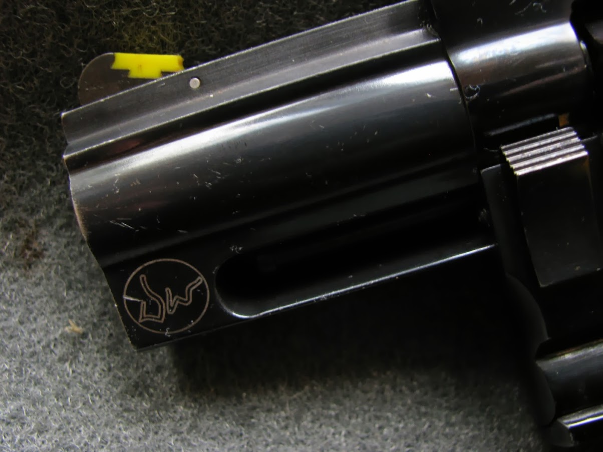

I have a "First Issue" Norwich model 15, 2.5" revolver. The front sight insert is broken and though it "works", I'd like to replace it, preferably with the same thing it has now. That would be a yellow insert ramped sight. Here is a picture of the gun.
I bought a red insert sight but it is larger than the one on the gun. I realized there were different heights but it's not easy for me to judge from picture. So, are the sights marked in any way? I can't see any markings. Where do you measure the height? Is there a standard height? Can anyone tell me what height this sight is from just looking at it?
Thanks
IMG_2073.JPGImage Enlarger
IMG_2072.JPGImage Enlarger

Actually, there are different height colored insert front sights, I have some of each. I think this might come from the same front sight height not working well for .22 lr, .357 Mag, .44 Mag, etc.
October 19, 2013 - 11:57 pm
My bad! Guess that explains why I can't hit sh-- . Guess I  gotta buy a lot of front sights till I get what I need . ebay prices are going to soar unless someone explains it to me. Just kidding. I'll figure it out and put nail polish on the ramp. Forgive me , it's Saturday night.  O D
October 20, 2013 - 1:41 am
Steve - can you post up a few pics of the sights with the different heights?  I don't think I've ever seen different height sights with colored inserts come through.  Thx.

I'll also take a picture today comparing the height of the yellow insert sight with the red one I bought. It's pretty clear the red one is taller.
October 20, 2013 - 10:34 am
Well, it looks like I've been very lucky.  All of the colored insert sights I've bought are identical thankfully. I really wouldn't want to get into that kind of an headache.  It's amazing what dumb luck can do for you.
