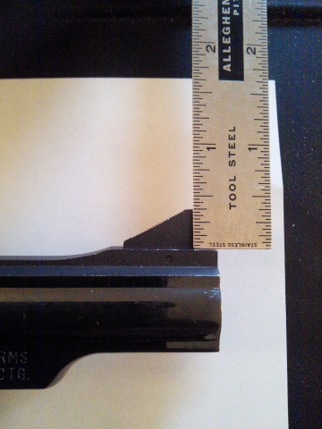

I need the front sight height measurement on a HS Sentinel MK111 with a 3.75 inch barrel.  Will someone with a stock Sentinel MK111 please measure the front sight height for me?
I have included two photos to show exactly what I need.  First is a photo of a DW  3.75 inch porker internal barrel nut shroud that I believe is from a model DW 15.  Because a HS Sentinel MK111 shroud is virtually impossible to find I will be using this DW shroud on my HS.  Obviously the front sight will need to be changed.  As can be seen in the photo it measures 3/8 inch tall.
Second photo is of my HS Sentinel MK11 3.75 inch barrel.   It is 3/16 inch tall.  This sight on the service model would be too short for the Sentinel MK 111.   So I figure that the stock HS Sentinel MK111 sight is somewhere between the two in the photos.  ( 3/16 - 3/8 inch tall ).
I include the photos to show exactly what dimension I am seeking.
Thank you to anyone who can help me out,  DD
I have included two photos to show exactly what I need.  First is a photo of a DW  3.75 inch porker internal barrel nut shroud that I believe is from a model DW 15,  possibly a DW model 15-1.  Because a HS Sentinel MK111 shroud is virtually impossible to find I will be using this DW shroud on my HS.  Obviously the front sight will need to be changed.  As can be seen in the photo it measures 3/8 inch tall.

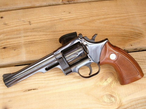

Looking at your first pic, it appears that is most likely a Model 15, due to the height. The Sentinels are 14-1 & 15-1 guns. Due to my logistics situation for a couple weeks, I am not able to send you the first hand measurement info your are requesting. However, click on this pic & it blows up nice-n-big, showing a shorter front sight...the rear is unique too.wink

Yes I agree that the DW shroud I am using is more likely a model 15 over a model 15-1.  The upslope on the front sight is quite steep and it is tall to say the least.  I am aware that the HS Sentinels equate to DW 14-1 and 15-1 .  Also the rear sight on the HS MK111 is different than the DW 15-1.  ( sits a tad lower I believe. )  All of this equates to the front sight on a HS MK111 being unique from others.  Hence my search for an accurate measurement.
What I did do was blow your photo up and used my rule against the computer screen to measure the distance from where the shroud transitions to the sight base ( top strap if you prefer.  The section the pin passes through. ) to the top of the sight base. Then I measured from the top of the sight base to the top of the sight.  Now I cannot say this was as accurate as something that could be done hands on at a machinists bench, but it is what I have to work with at this point in time.
As the photo was enlarged these two measurements should have enlarged in a proportional manner to each other.
Sight base measured 1/4 inch in the blow up.  Sight measured 1/2 inch from top of sight base to top of sight.  I say again these measurements made on the computer screen may very well be 1/32 inch off.  So the sight measurement is X2 the sight base measurement.
I know that on my two HS's the sight base measures 5/32 inch from where it meets the shroud body to the top of the base that the sight sits in.  5/32 X2 =10/32 =5/16 inch.  My original estimate from eyeballing was that I would be in the 1/4 inch area for the front sight height.  Certainly 5/16 inch  falls between the 3/16" of the MK11 and the 3/8 inch on the DW model 15.  5/16 is just 1/16 of an inch greater than my 1/4 inch estimate, so perhaps I have made some progress.
Sometime in the future when you have your HS MK111 in hand a measurement would be much appreciated.  I will be curious how close my rather unorthodox method using your photo on my computer screen comes to a real life measurement.
Good news is I understand that a replaceable 15-2 sight will in fact fit the slot in the porker shroud.  It just has to be drilled and pinned.  I think there is a 15-2 sight available in .250".  Heck,  I could even go fiber optic if I wanted to.
Anyway, thank you for the photo.  I will be curious to see what an actual measurement reveals.
