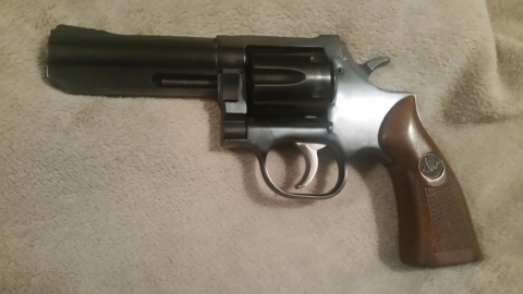

I have a DW model 14 5 in full lug from Palmer Ma  in 357 mag that is damn near perfect. I am always surprised  when people downgrade the fixed barrels.. I understand the DW trademark was change barrels however they are superb firearms in their own right and Very rare in fixed bbl configuration. They shoot every 20150913_203105.jpgImage Enlarger
20150913_2031431.jpegImage Enlarger
bit as well as their S&W , Colt counterparts(often the trigger is actually better). I have looked for years and cannot even find a picture of another one like mine.
