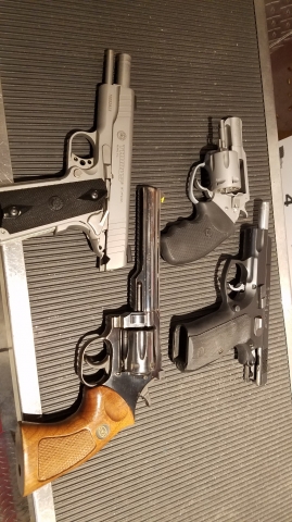

Was looking forward to my first outing with my model 15-2. Plus it had new shoes to show off.  Glad I had brought along other toys to play with.
Got through one cylinder in single action mode without issue. Really like the accuracy. Wish I had brought some .38 special though. Even in this frame with the 6 inch barrel, it packs a kick with 357 mags. Going have take my k-frame Smith with 4 inch barrel and compare next time.
Second and subsequent cylinders in double action were problematic. Among issues cylinder lock up, inability to release cylinder, etc. Had one light strike. Ejecting cartridges was a struggle.
Thankfully brought a couple of tried and true 9s, the Taurus 1911 and older CZ 75b. Even a few rounds with the factory new Charter Arms Pathfinder.

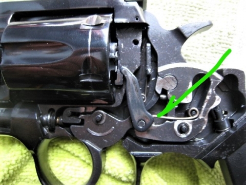

I'm sure you set the B/C gap. If you don't have an allen wrench for the side plate screws, you need one. Take the grip off and check for loose side plate screws. Even a little loose the side plate won't hold the hand in place properly and not advance the cylinder. Another thing you can try is check that the trigger return spring hasn't slipped off the "ledge" on the trigger where it rides. Photo shows trigger return spring. Behind the hand you'll see a ledge on the trigger the spring should be riding on. I've had this happen at the range and it will bind the trigger. If you haven't already go to the Gunsmith section of the forum and check out the "Average Joe" tune up. It's a very helpful "how to" tutorial on breaking down your 15-2. It's very simple. Good luck.

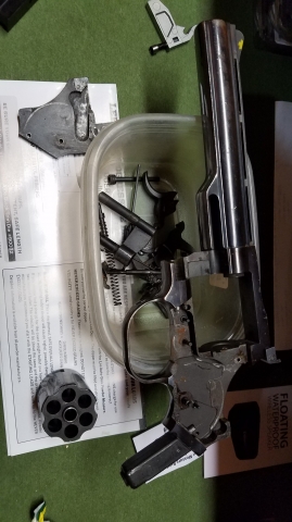

Disassembled the revolver this evening. About as far a I got. It is pretty filthy inside.20200303_185150.jpgImage Enlarger
