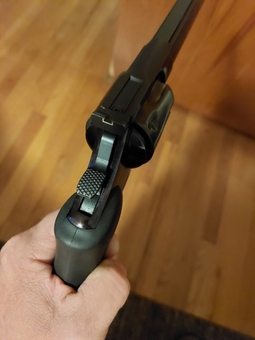

I don't know about that Kurt?????3-12-22-013.jpgImage Enlarger
March 13, 2022 - 9:20 am
All large and Supermag guns have knurled hammer spur. Your gun is definately a blue gun, one of the first 10,000 made with the shorter hammer spur. It is most definately aftermarket. Dan Wesson made some early factory porkchop nickel guns and a few 15-2 small frame guns, but not large frame guns in nickel or Chrome. It chrome, enjoy it. It is a very durable  finish but can affect tolerances.

March 13, 2022 - 9:52 am
It could also be "in the white" so be careful of that; hard to tell from the picture.

I just noticed the second and third pictures. The hammer spur looks like a long spur but the serial number number indicates a blue gun with a short spur. I think when the gun was plated the hammer was exchanged for the long spur version.
