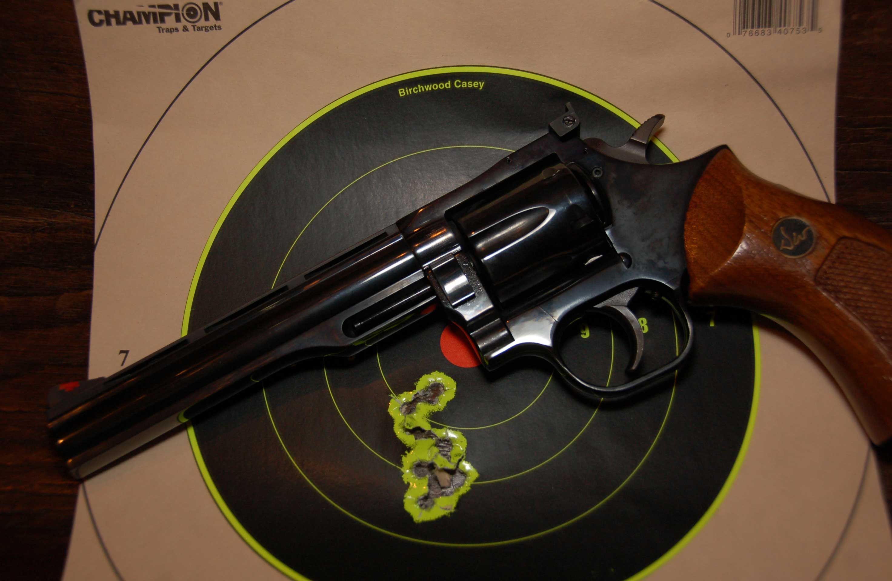

Simply put, that most accurate handgun I have ever shot (except for my contender, but they don't really count).
It took a little sighting in, but MAN what a sweet shooting gun!  Granted these were at only 15 yards, but Even at that range I don't usually get groups like this, not for a long time anyways.  And this was with factory ammo.
So, I'm waiting for my 38/357 dies to arrive so I can start working up some loads with wadcutters. Any favorites out there?  I currently have some 700x, 2400, 4227, and H110.  I'm guessing the 700x should do nicely.  May have to pick up some Unique as well.
The future looks bright!DSC_0807.jpgImage Enlarger

That's great! Looks like you have a shooter there.

Nice group! I've had good success with bullseye gf or my 38 wadcutters. Everywhere I look for loads guys are raving about 2400 and cast bullets so I'd look into that as well. I haven't found any 2400 lately so I haven't tried it. I will say that I don't like 4227 for 357's. it's dirty and leaves lots of unburnt powder.
Good luck finding a load that works for you.
