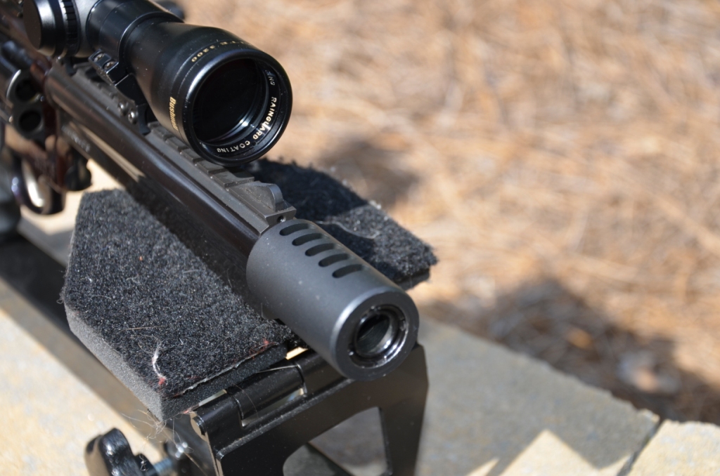

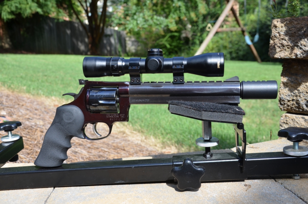

My .44 with railed shroud and muzzle brake. Looks and shoots great
DSC0312-1.JPGImage Enlarger
DSC0313-1.JPGImage Enlarger

Wow - I've been staring at these pics for 15 minutes straight.  Gorgeous piece - nicely done.

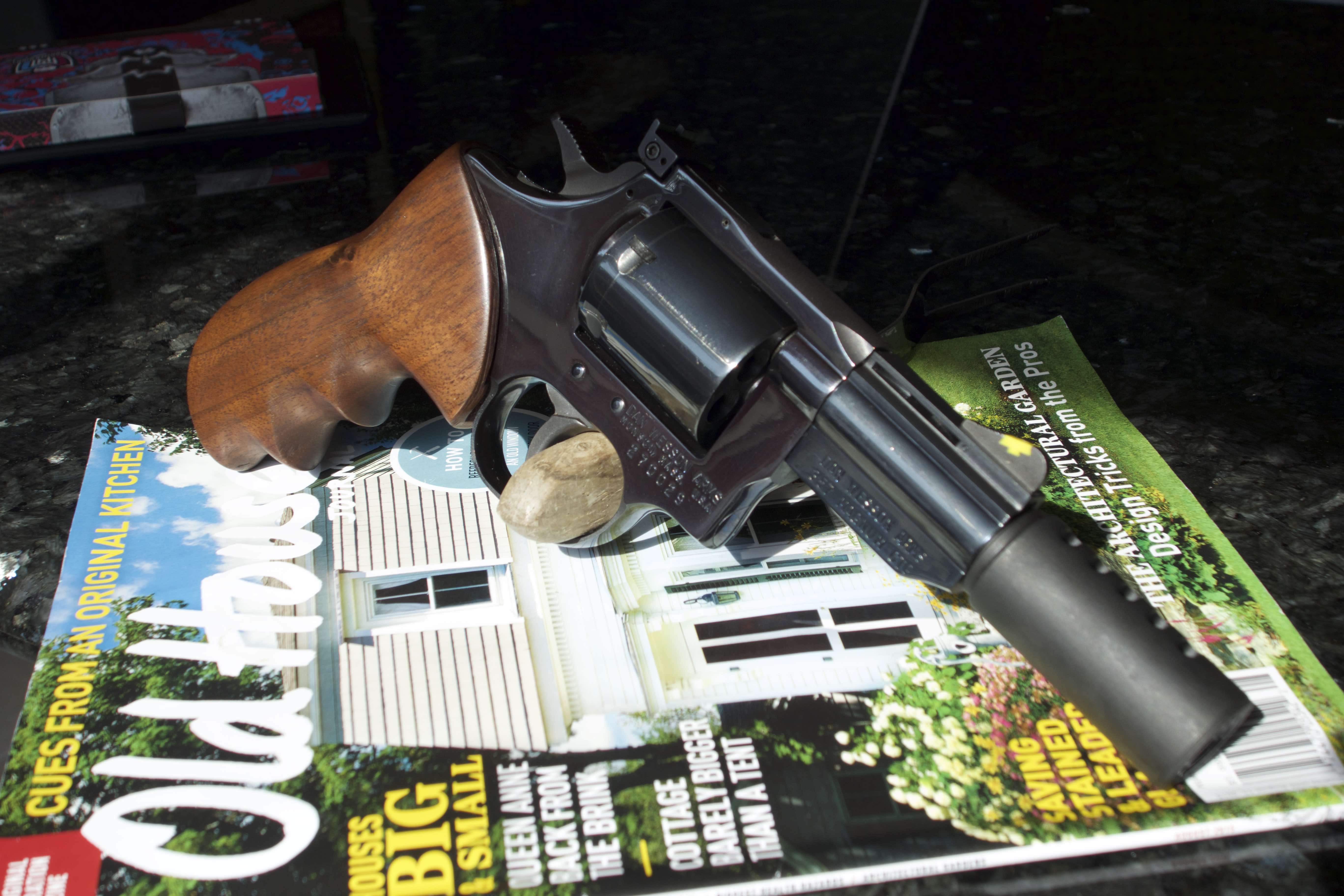

A little more picture porn.  Not too good a good picture....
M15-WBreak.jpgImage Enlarger

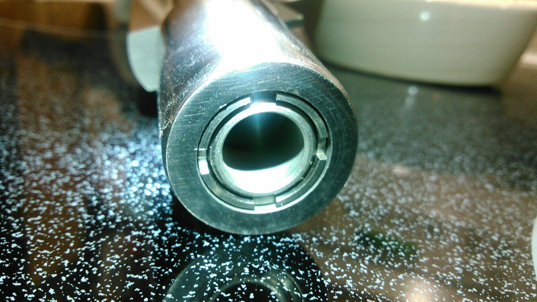

Maybe a question for EWK but has anyone ever polished the stainless brake?
Dave
33
September 1, 2015 - 8:48 am

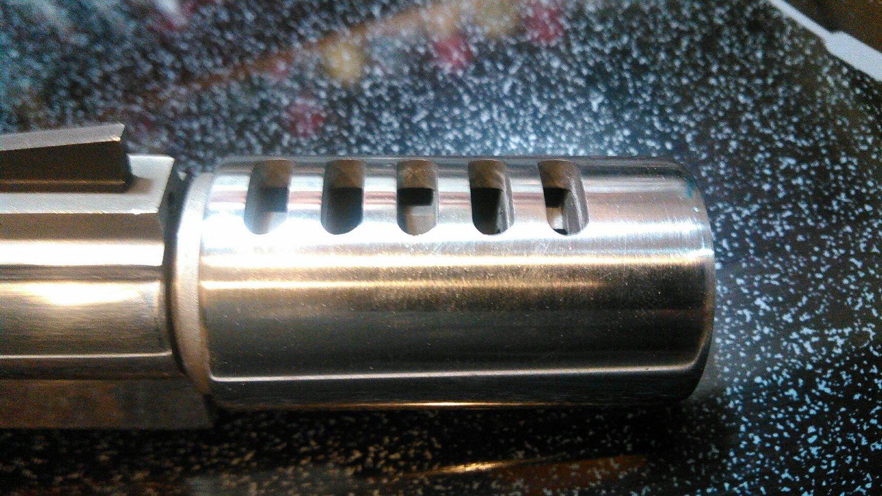

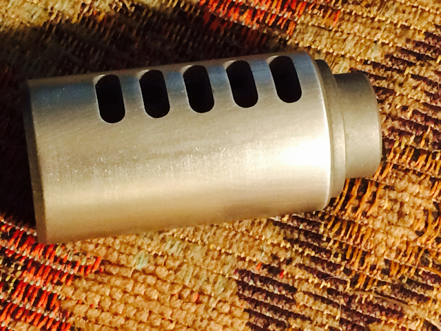

You have inspired me.
A quick adjustment using sandpaper, a wire (stainless) bore brush and a rescue (green) pad.
It's just a start, but it's getting there. Carppy cell phone pics. It looks better than these pics show.
Brushed-Brake-1a.jpgImage Enlarger
Brushed-Brake-2a.jpgImage Enlarger
I tried a brushed finish and it actually looks pretty good.  5 minutes work.  Gotta go back and spend another 5 on it to get it really good.

Thanks for posting all the pictures, they look great!
Sure, as Mike has shown, it doesn't take too much to polish it....to get it perfect, a couple things-You have to careful not to "washout" the ports. What works best is polishing cloth/emery cloth-keep it tight as you go around it, and you won't have to worry about washout on the ports. Get a barrel tube and carefully clamp it in a vise so you can easily go around the brake, and it will work great to get all the matte finish off and the machining marks. I'd recommend 180-220 grit...it will load up kind of fast, but you don't have to worry about taking too much off, and you don't need to buy several different grits.

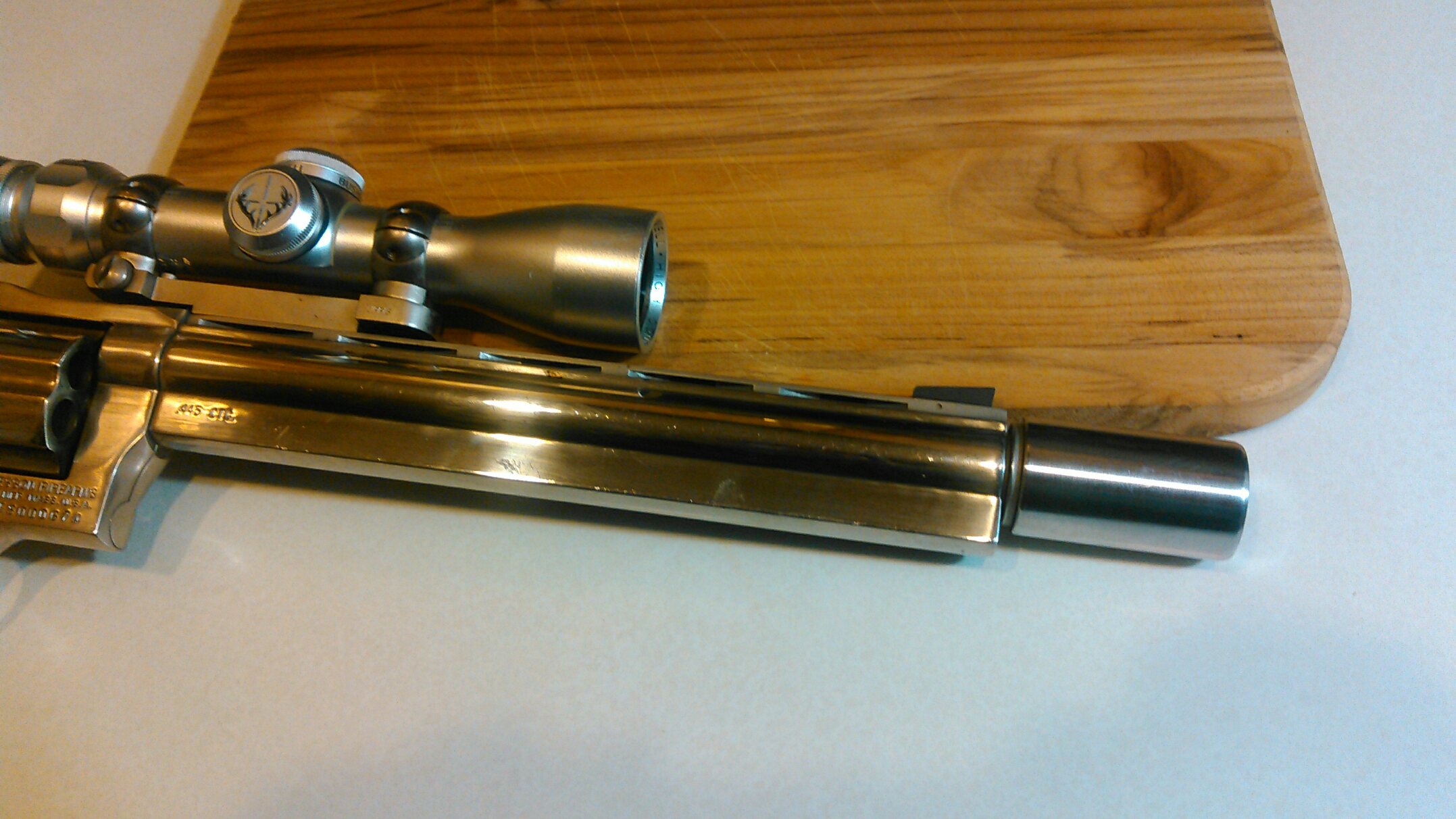

Ok finally got to spend some time in the shop, took about 20 minutes. I ran a bolt through it and put it in the drill press. Set it at 560RPM used wet 220 then wet 500. Turned out good could not find the polishing compound.
KIMG0057.jpegImage Enlarger
KIMG0056.jpegImage Enlarger
KIMG0058.jpegImage Enlarger

460smdave, your polish job turned out looking great! It compliments your 7445 very nicely.drool
