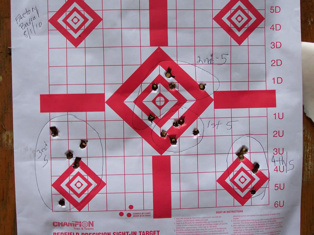

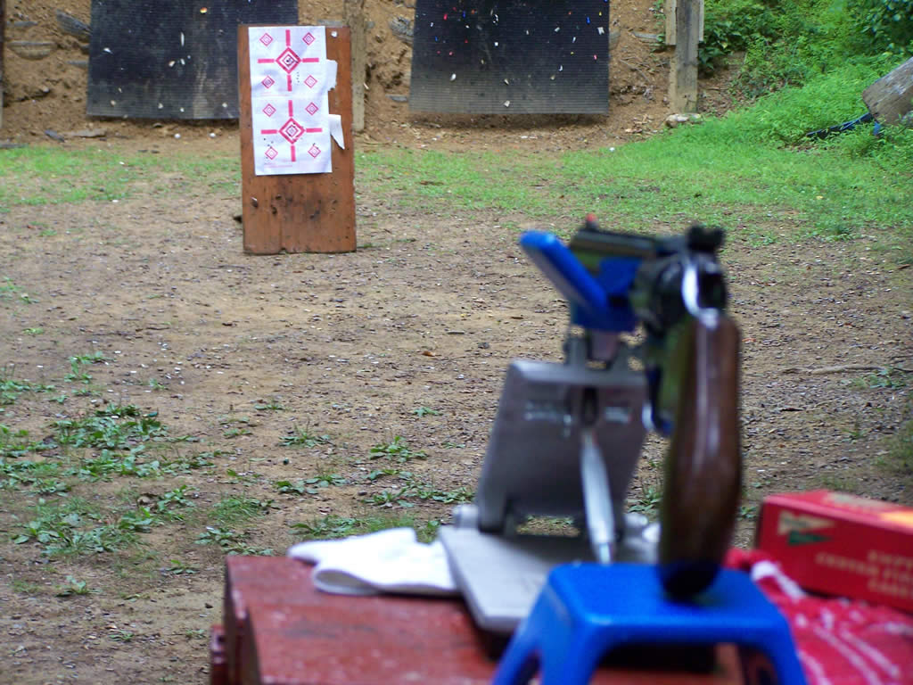

Well the clouds parted and the sun came out so off to the range I went. I took my DW Pistol Rest along to help with the test. I only shot about 15 rounds with Eric's barrel and 20 rounds with the factory barrel and got pretty consistent groups at 15 yards. I used .357 Mag, 158 gr SWC over 6.0 gr Unique, Win SP primer.
Here are some pictures of the results:
This is a shot of the range:
Target using Eric's barrel: The first 5 shots were before I adjusted the rear sight but the group wan't bad.
The target is with the factory barrel:

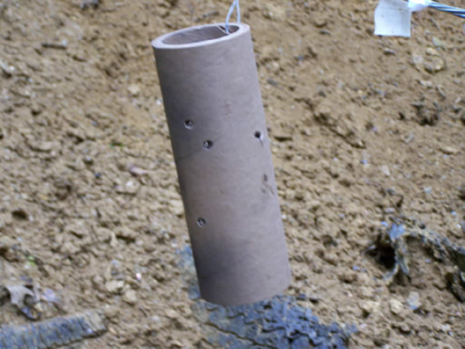

I shot five at this paper tube at 25 yards free hand and hit it four times with Eric's barrel. Works pretty good.

That 3rd group of the EWK barrel looks like a 1 1/2" group to me minus the low #5 hole.
Whether barrel heat or loss of shooter concentration, the last shot of the group seems
to "creep off" alot of time for me. I would bet money that after a 200 rnd break-in this
barrel will produce a one ragged hole group at this distance.
Nice job Jagg !

Yeah, even on a rest you tend to pull one once in awhile. I didn't have a lot of time and may have rushed it. I will give it a good test next time.
