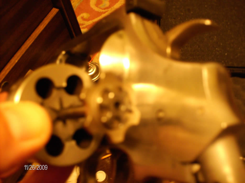

thanks, I might not even need the assembly, but I was wondering if it's normal to be able to pull of the "star" extractor off the end of the rod?  It looks like it's a torx end on the rod so maybe that's the way it's supposed to be?

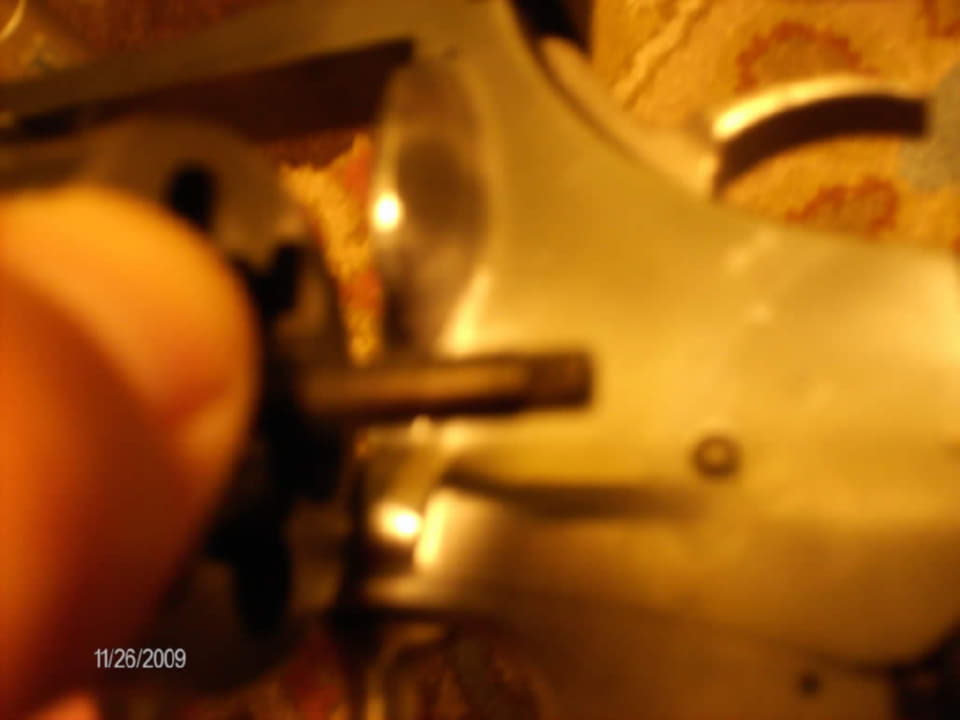

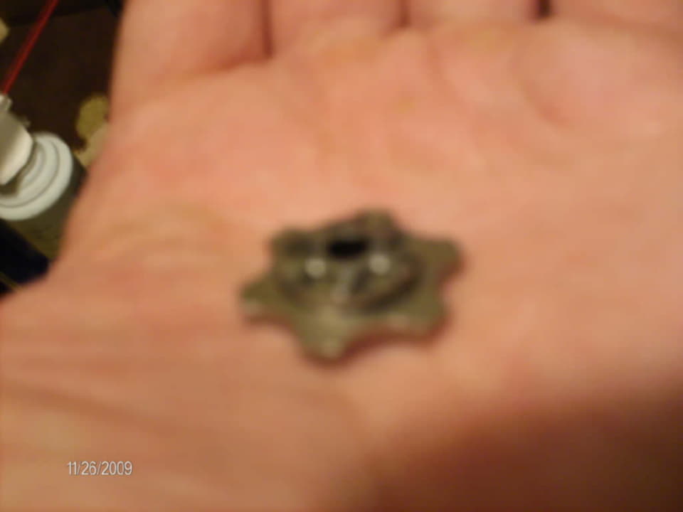

I figured the rod unscrewed, mine is a little bent, not bad.  What about the actual star istself?  I'm able to pull the star right off with some pressure, it looks like the star is just pushed on the extractor rod, the end is a torx type end...is that normal?

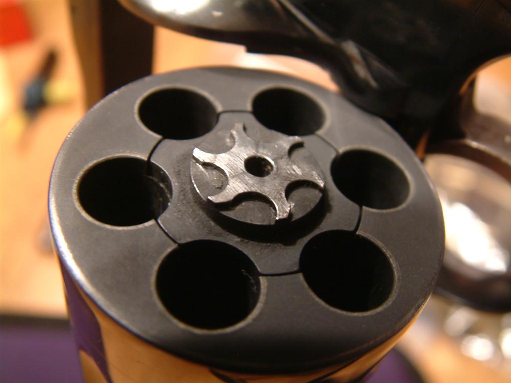

kevenn said:I figured the rod unscrewed, mine is a little bent, not bad.  What about the actual star istself?  I'm able to pull the star right off with some pressure, it looks like the star is just pushed on the extractor rod, the end is a torx type end...is that normal?
If I'm reading you right, you're saying that the star is slipping down the shaft like this?
If so, then no...that isn't supposed to do that & it needs fixing.
I haven't seen any torx ends on these, but I do have a couple that look slightly like an allen style hole. I don't know if that was intentional, or not...I haven't heard of any mention of that area yet, as something that would require a tool.

Chargerfan those are great picts!  It looks like you have a stop at the end next to your star so it can't come off...mine doesn't have that!  It must have broke of so I need that assembly.  If you look at the one picture you sent beneath the stop there are ridges (torx like) grooves to keep the start secure, that was what I was looking at.  Anyone know where I can get another rod/star extractor?  It looks like DW wants the gun to be sent in to be fixed.

I looked when I got home and my star extractor is different, it looks like I never had a stop at the end to begin with.  I doesn't look like it broke off or anything like that.  My picts are bad but you'll see what I mean...anybody with an older Monson DW to compare?

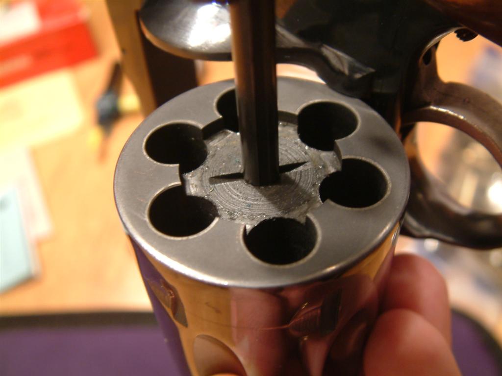

Ok, the pics I showed above, are of my Model 15 (small frame). I posted those as a general reference pic, because that's all I had right then...that's why it looks different than yours. Sorry about that.Embarassed
Yours is the first I've seen of a separated star & shaft. It's definitely broken, but I bet a smith could fix it fairly easily. It's probably just a broken weld, I imagine.

The torx end I'm talking about is at the end of the naked rod in my 1st picture (the one w/o the star) I could try to epoxy it. However I think I might just try and find a used/new one.  I've tried contacting Genny/Keith at DW 3x and I haven't gotten a response...I would just need the extractor and I think I'll order a new ejector rod to since mine is a little bend.  I didn't find anyone selling parts in the DW classifieds like someone else posted...any thoughts??

OK, now I gotta post pics of my 40's...  CF, I don't have the "STAR" under the assembly like you do--mine only has two slots.  Pics will be added tonight.
December 4, 2009 - 9:49 am
Also--based on these pics, 40'S EJECTOR RODS DO NOT UNSCREW!!!.  We should post this as as a sticky somewhere about the ejector rod.  That Torx you are mentioning is an interference fit from the factory.  It was probably pressed together.  Youn can attempt to peen the rod a little and use some red loc-tite, but it probably won't work.  A REALLY good TIG welder may be able to hit the top by the star, but once it is together, that's it!
