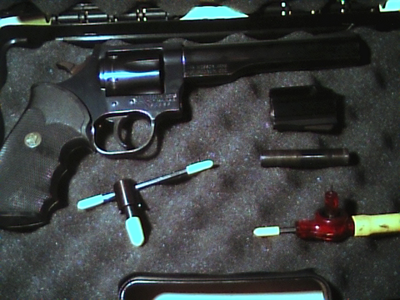

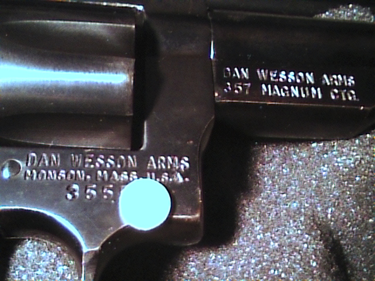

Hello all
I have read many forums and just cannot for the life of me decide which model DW I have. Please Help?
dwf-sign
Thanks in advance and I hope the pics are not too big
jackwagon
March 21, 2011 - 10:48 pm
From the pics it looks like a model 14-2. It is hard to tell at the rear sight, but it looks like it is fixed, which would mean it is not a 15-2 which had adjustable sights.

Correct it is a fixed sight well if it can be called a sight  lol just really a groove in the frame
March 21, 2011 - 10:52 pm
Yes, a groove in the frame is more like it, the front sight should also then be a black pinned lightly elevated front blade without a colored insert as well.  This was Dan Wesson's answer to a service revolver.
March 21, 2011 - 10:54 pm
Yip 14-2 great shooter Enjoy!
