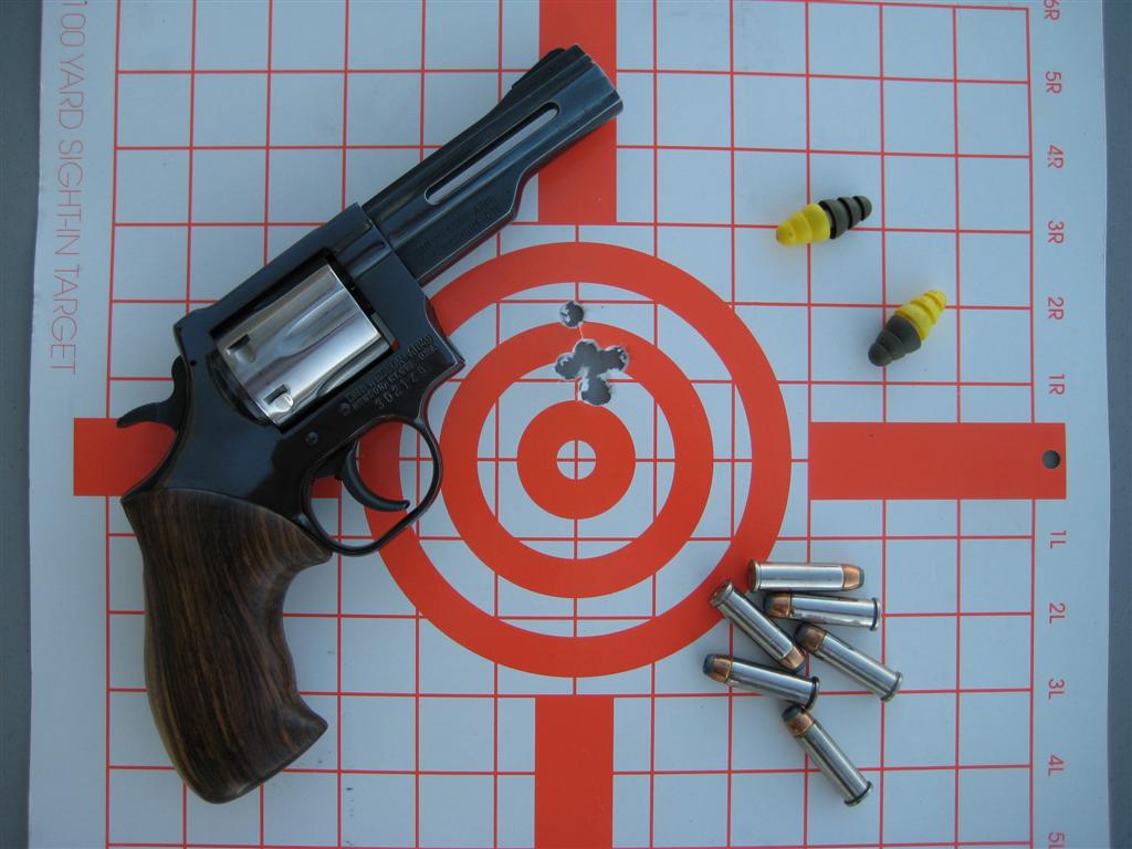

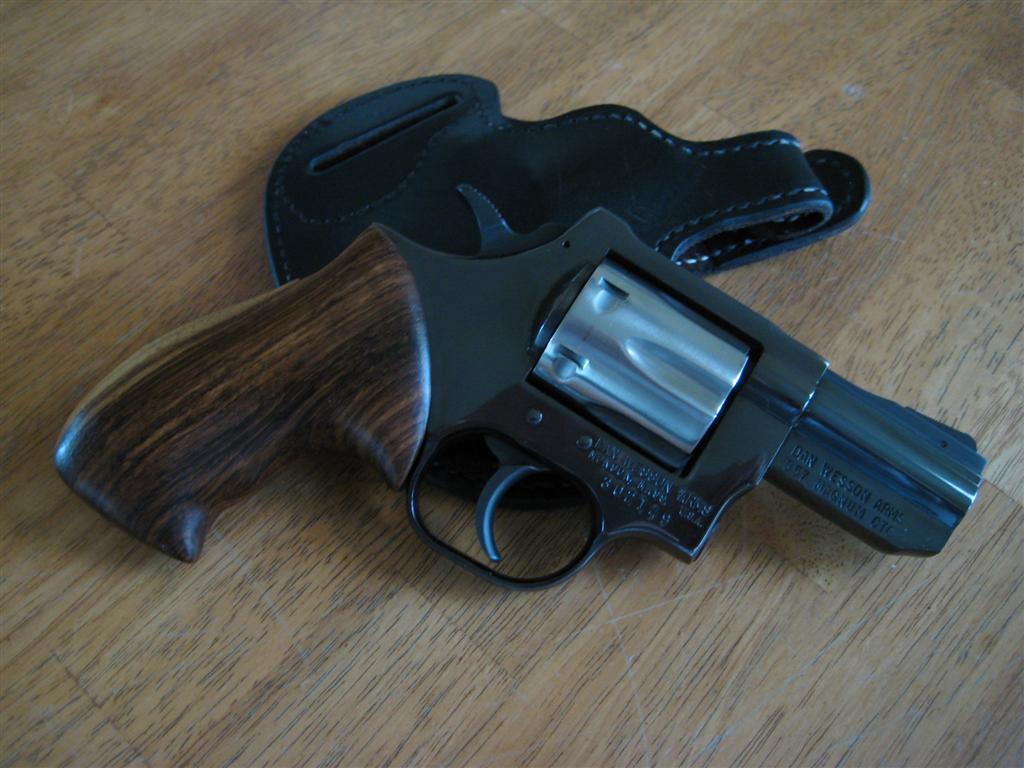

Sure, as long as you have an idea, go for it !!!  I have a few I've modded up a little for my personal taste.  Here are sold older pics of my CCW 14-2 -- it now wears a bobbed hammer also.
April 22, 2011 - 8:30 am
Or how about everybodys favorite toy... a DW22

Nice pics Shoot.  How did you get the slotted shroud for the 22?  Is that 22  grouping with the gun on a rest?  That's good shooting.  (In my best John Wayne voice from Big Jake.)

I just succumbed to dwaswith a new-to-me 14-2 with a bunch of barrels and now you go and show me stuff like that! I've got a 4-inch 15-2 barrel that has a little bit o' rust and I was thinking of having it re-blued. NOW, I'm thinking it'd be pretty neat with one of those slots down the side, a silver cylinder and a flash suppressor from EWK! I KNEW I should have bought one on my order yesterday!

I had a buddy with a mill do the slotting for me--I did some detailed measuring and gave him the specs I wanted...and Presto !!!
22 group was off a nice set of steady sandbags--I'm good offhand, but I'm not that good laugh...
It's hard to tell, but if you scroll up and take a careful look--the slots on the 14-2 was my test shroud. those slots are a little narrower than the ones on the .22 shroud.  The wider slots look much better if you have the SS barrel liner to show off.
The barrel liners are stock DW SS ones, but I put a high polish on them with the lathe.
