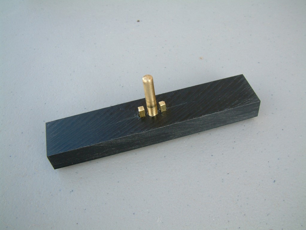

Yes, I'm still new at DW stuff but up to now have not run across a barrel wrench that looks like this. screwy
http://heffronfirearmclassics.com/DANWESSONBARRELWRENCHBYHFC.aspx
Hossman proud-to-be-an-american

Might be better than stock DW wrench but not better than EWK wrench.
August 27, 2011 - 5:57 am
I'd be very careful with a wrench like that. just like the early wrenches that had a "barrel spud" and an offset handle, it will be more difficult to maintain direct downward pressure on the barrel nut. That original DW design resulted in rounded out barrel nuts that were very tough to remove. Also, the offset handle allowed the leverage to easily overtighten the nut.
Save yourself a lot of pain, just use the EWK wrench.
August 27, 2011 - 8:16 am
NOT an EWK laugh ..... I recently got this one with a DW I purchased.  This one just sits on the bench to remind me to use an EWK wrench.

August 27, 2011 - 9:45 pm
Dan Wesson Small Frame Hex Drive Wrench
I would use this from EWK with a wrench if I ever needed extra leverage.

That thing is a joke.  Look at your DW's, The muzzle is almost always very close to flush with the barrel nut.  That's why DW and EWK barrel wrenches have pins that fit into the slots in the barrel nuts.

With that wrench the odds are high that you would eventually ruin a barrel nut. Also it would be difficult to use because you'd have to keep it perfectly aligned where the EWK  and DW tool eliminate the alignment issue.
August 28, 2011 - 6:03 pm
Looks like there is a large profit margin with the Heffron wrench if that's what you want to call it.  Looks more like a piece of flat iron with a 90 in the brake...
August 29, 2011 - 5:46 am
It could be used as a back scratcher when not tearing up your Dan!

Never ever try a shitty wrench on your Dan Wesson nut. Never.

The guy that introduced me to DW had a homemade wrench for his guns.  He took a brass t shaped pipe fitting and ground down the center leg till he had two nubs to mate with the grooves in the barrel nut.  It worked, but not very well.
August 30, 2011 - 3:57 pm
Probably because brass is too soft.  Could be pretty, though.

I believe Heffron is supposed to be coming out with a new Dan Wesson wrench from what I have heard.
September 3, 2011 - 12:32 am
Funny how when Hefferon he was working on a tore up DW he
bought a wrench and couple barrel nut from Eric... or should
I say he "ordered" them anyway frown
September 3, 2011 - 1:29 pm
Stick with the EKW wrench, you can't go wrong, well made products.
