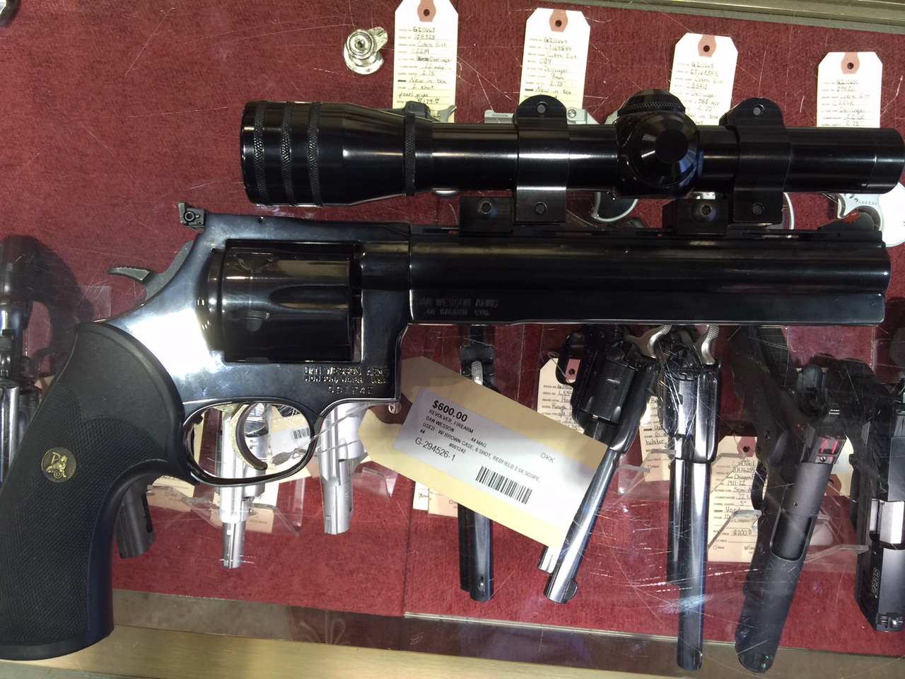

Hello all I located and am interested in gaining some information prior to adding to my collection.
DW 44 , monson stamped with 8" , 6" , 4" barrels with shrouds.  The barrels/shrouds are ported and it comes with dw wood grips, barrel tool kit, and 4", 6" non ported barrels along with the suitcase and a Redfield scope.  Condition on weapon looks overall good with slight cylinder ring and has a haze over bluing that I hope will oil/polish out.  serial is 00124x
Question did this set come with 8, 6 and 4" barrels?
Two sets of grips?
Scope?
ported and non ported barrels.
Thanks for site and hopeful in getting good info.

Todd- It may have been configured as a pac or may have been put together over time. Does the hard case have a sticker that matches the SN? Scopes aren't normally a part of a pac.

Todd- I just looked at that pricetag; BIN!!!  even if it's just the gun as is, it's a deal.  If it's all barrels and the case included, it's gtdw  I may have to drive over there if you don't...

OK now that I've calmed down, seriously - the 4" BA is very rare and can easily go for 400 or more.
The 44 packs generally came with case, frame, 6 & 8 BA's with a Power Control and a regular barrel for each length. The 4 could have been ordered with the pac or later. Check the cutouts in the foam and you can tell if it came that way from the factory. Packs came with 2 grips, usually 1 wood and 1 pachmyer, but special orders could change any of that. The tool, gauge and extra front sights were also included as well as a buckle and patch, depending on the year sold. Of course everything could have been bought separately and at different times. Still rare and the scope is a plus.
If the price is really 600 for everything then it really is a steal (GTDW)!  occasion
