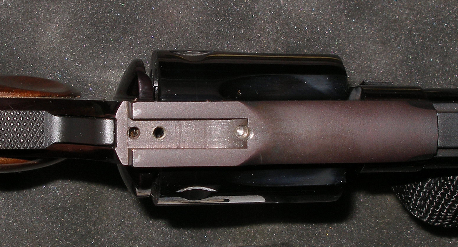

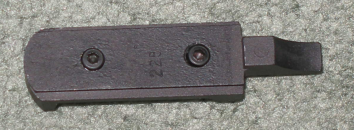

Thats just it. My gun never came with the original rear sight. It came with a little scope mount instead.
I removed the scope mount and this is what it looks like .
dw-scope-mount.jpgImage Enlarger
DW-TOP-REAR-SIGHT.jpgImage Enlarger
September 3, 2015 - 7:14 am
Your gun was equipped with a sight that had the elevation screw positioned all the way to the rear (left example in the photo).  You'll need to look for one used on ebay or gunbroker.
September 3, 2015 - 9:57 am
That "little" scope mount may be a new addition to scope mounting options. A few more pictures would be interesting. I think a Millett lg frame sight would work. I checked one I have and I think the screw placement matches the one on the left in Harly's photo.

The sight base is an older Thompson Contender Insta-Sight base made for the Dan Wesson revolvers.  The Insta-Sight was a reflex sight with a lighted crosshair that needed no batteries.  I believe there are other posts about this on the forum that have additional pictures of the mount and sight.  Both the mounts and sight do show up now and then on the auction sites but they are getting hard to find.  The sight clamped onto the base and the base will also accept 3/8" clamp on bases like for 22 scopes.  The Insta-Sight clamps on very tight and would probably hold up to the recoil of a 357 SuperMag.  Not sure how any other clamp on rings would do.

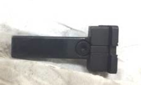

September 10, 2015 - 12:13 pm
Oh happy day!! After some digging in the parts dept at Dan Wesson, they found me the exact one that I needed. I am one happy camper. I'm gonna have to get some reloading equipment next because I will be shooting this baby ALOT now…………WHOOOHOOO!!  Thanks for that great picture Harly, it made showing DW what I needed a lot easier. and thanks rwsem for the contact info.
You guys rock!…….  LONG LIVE THE DW SUPERMAG.
