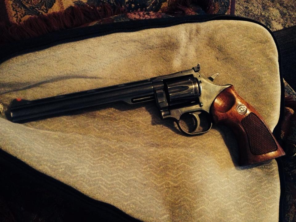

Picked this up for $350 the other day. Took it out shooting and the cylinder started to hang up. Brought the gun home and couldn't even get an .002 gauge between the barrel and cylinder. Will fix once the wrench get here just wondering if i got a good deal on the gun.10299373_10203307861634124_365479074_n.jpgImage Enlarger

Welcome to the forum, thats a good price for a nice 15-2. I'm sure a proper gap will fix it right up. Let us know how the next range trip goes.

.006 is where to start,  you got the one I think most of us have!  Welcome, look around and see what you can find!  occasion

The current going rate for the vented light barrel in 8" is around $250, so actually you got the frame and grip for $100 and that's a steal.  The vent heavy barrels come up often on the various sites mentioned above, good luck and enjoy your DW.big-grin

Perhaps that is why you got a good deal. Fix the gap and it should be fine.
