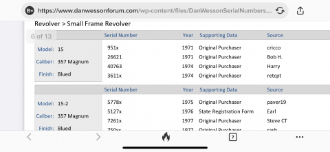

EAA831E1-000F-48AE-ACEC-F5822B5C3170.pngImage Enlarger
Per the DWF Serial Registry, it looks like it’s pre-1975.  A very nice keepsake remembrance of your father.
https://www.danwessonforum.com/wp-content/files/DanWessonSerialNumbers.pdf

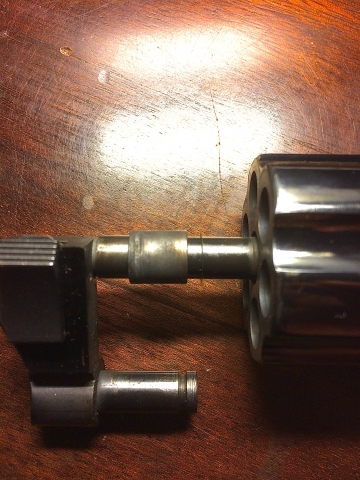

My early 15-2 is only a few hundred guns earlier than this one. Your cylinder will have the removable collar/gas ring. It may come out easily, or it may be very stubborn, or it may never come out, but it’s there. Interesting design that was changed to a better system around 1977 or 78. Not problematic unless you need to shim for excess end shake; then you would need to get it out to place the shim underneath it.E8550162-71E5-422D-823B-672D09B24E0D.jpegImage Enlarger

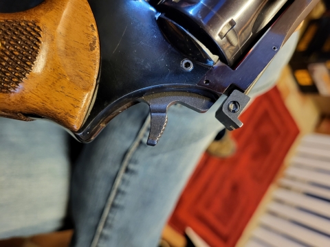

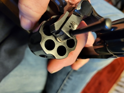

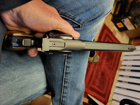

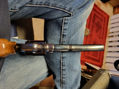

20220421_201556.jpgImage Enlarger
20220421_201607.jpgImage Enlarger
20220421_201627.jpgImage Enlarger
20220421_201649.jpgImage Enlarger
more pics of Dads DW

Why pork chop?

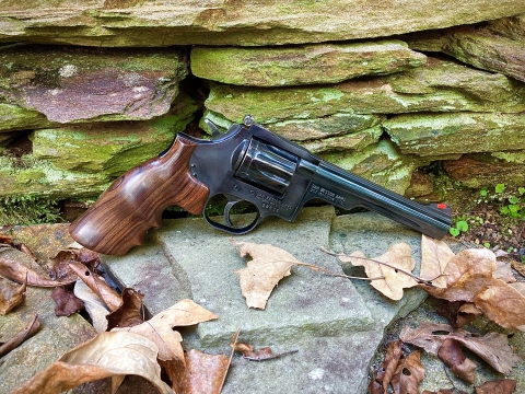

Sorry to mislead you; your gun is not a pork chop. All previous DW’s (prior to the 15-2) had what we affectionately refer to as a pork chop shroud which has a leg that comes down in front of the frame that actually holds the cylinder in place and locks the shroud in position. Here is a photo of my 15-1 which was the last porker. Great to see such nice photos of your DW; thanks for sharing!!265B0B49-1F1F-4A17-9CCB-5C5E700EC28C.jpegImage Enlarger
Great info, thanks for posting.occasion
Unless my memory is failing me again, this is the first I've heard of this collar. Maybe it's brass by chance? The one in your photo appears fairly worn on the outside, leading me to presume it was a press-in brass piece.

Definitely not brass; that would never hold up to the hot burning gasses. It’s a precisely fit tube of hardened steel that is pressed into a milled out recess at the front of the cylinder. Be aware that this area receives the same flame cutting as the top strap! I recently purchased a couple of replacement parts from Numrich, and luckily they were a little longer allowing me to file them down to a perfect fit on my two early DWs. Almost zero end shake now. The new ones are Stainless Steel.

I bought the gun used, and frankly, abused. Previous owner/owners had subjected it to many viscous loads judging by the severe ratchet marks on the breech face and the amount of end shake present. Yet, it always shot very well despite the damage. Can’t really say it shoots any better now, but at least I know it’s not getting beat up any more when I take it to the range. End shake is an insidious enemy of a revolver.
