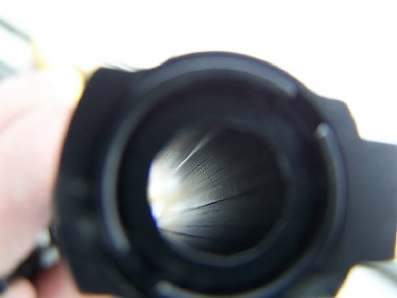

February 15, 2010 - 6:21 pm
Ok, here's the bore after another 200 rnds I can see a difference, whole gun seems to be running smoother. I guess that will happen when you set around for thirty years. I even have a real line showing on the cylinder. Image Enlarger

February 15, 2010 - 7:09 pm
robhof said:Check Ebay for grips, it's one of the few things they still allow gunwise.  For polishing up the bore, I highly reccomend Veral Smith's kit, look up Lead Bullet Technologies.  His kit is composed of soft lead slugs that you use to check the smoothness of the bore and to gauge the bore if you have calipers, then a lapping compound that you apply to your own cast bullest and a light powder charge, he has very detailed instructions.  The kit has enough slugs that you can check the bore after 20 or so rounds and as often as needed to get a smooth pass through.  I've used the kit on all my guns, even my b/p ones after it improved my DW's accuracy.  It worked equally well on all guns and drastically improved the accuracy on most and made an improvement on the rest.Welcome
Thanks Rob, Not sure I am ready to fire lap just yet. I have read alot about guy's like your self who swear by it. I guess I am leaning towards old school way of, how you'd say "using elbow greese" by running alot of lead through it. I know barrel break'in is a big debate but I really think it has made an improvement. Gunsmith said a 1000rnds to get the bore looking pefect, but  I will wait for better weather and a ammo deal on the next 500.
