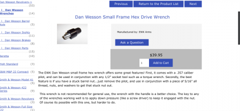

One thing I bought and have used several times is this tool from EWK. It's a barrel nun tool that you can fit a socket wrench on and use a breaker bar to loosen a stuck barrel nut. You can get them at EWK for $40 well worth the price. I can then put guns in a vice with something around it to protect the gun and then use this tool with a breaker bar and socket!Screenshot-2025-02-18-10.09.45-AM.pngImage Enlarger

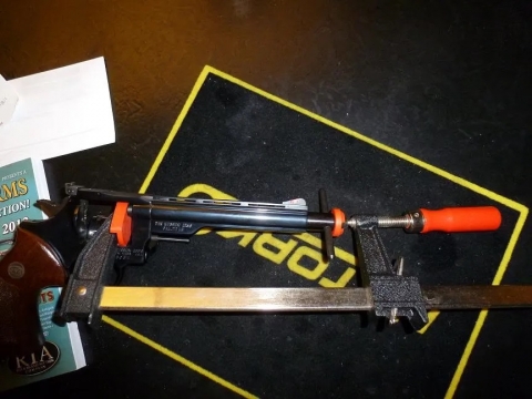

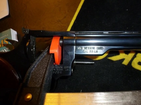

I keep bringing this up whenever this subject pops up - this is my preferred method which has never failed me.  The reason I like this method is because I prefer NOT to stick a steel threaded rod down the barrel, and you don't have to mess around with tightening nuts down on the rod and barrel, further increasing the possibility of damaging the barrel.
You just need a regular EWK barrel wrench (see the sidebar on the forum home page) and a 12" Bessey Bar Clamp (OR SIMILAR).  Just clamp the wrench down on the barrel and break the nut loose.  As soon as it breaks loose, take the clamp off and remove the barrel nut.  It's really that simple, but if needed apply a little heat to the nut, (I have never needed to heat up a barrel nut with this method).  The objective is to keep the tangs of the wrench in the barrel nut slots - this will do it.  I guess there is a chance of spinning the whole barrel out, but that has never happened to me and if it does you can figure it out from there.  You can get a "Pittsburgh" brand clamp at Harbor Freight for $4.50 and it will do the job - it will be the best $4.50 you ever spent.  An original Bessey Bar Clamp is $11 on Amazon or $16 at Home Depot.

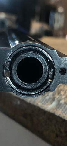

While we're on the subject... I have one were the barrel nut groves are "stripped" (rounded over in the loosen direction) so the tabs on the wrench can't catch on much of anything.... Any advise.... hate to think I need to use a hammer and chisel frown

While we're on the subject... I have one were the barrel nut groves are "stripped" (rounded over in the loosen direction) so the tabs on the wrench can't catch on much of anything.... Any advise.... hate to thing I need to use a hammer and chisel frown
I had one that I had to use a small punch and hammer to remove. I used a punch to keep from cutting the nut and causing it to dig into the shroud. Yes, it ruined the nut, but it came out.
