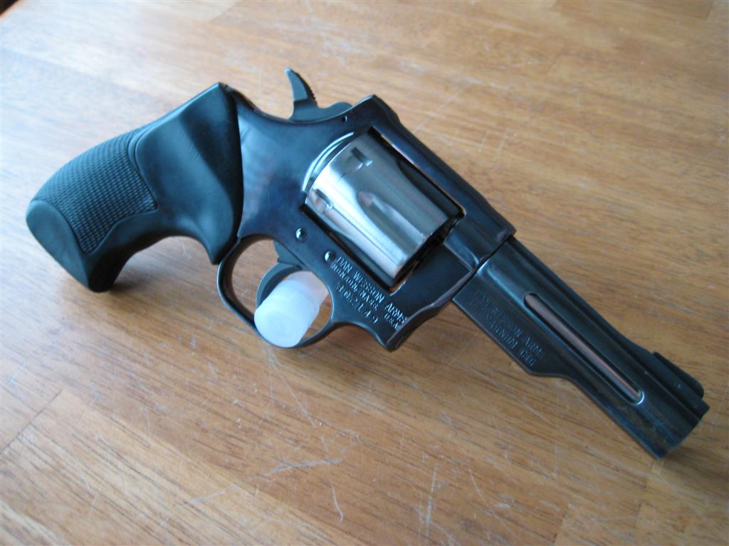

What do you do when you have a bunch of parts staring at you....;)  Make yourself a one of a kind DW !!!  I took  my high polish 14-2, fitted a SS cylinder, slotted an old 14-2 shroud, and installed a SS barrel... The result....
Ugly day outside, so the pic isn't that good.  I'll send the shroud to Hotbluer some day, so it will match the frame better.  I learned a lot on this project about DW cylinders (the hard way).  I ended up using the star and rod from the original blue cylinder because the SS threads were kind of messed up.  I really like the looks of this one, and I have another project in the works that should look even better 🙂

Shoot you beat me to it, I wanted to be the first to slot a 4". Oh well it turned out nice. Can't wait to see what you turn out next.Worship

Very nice, especially the slotted shroud. A rainy day project lurking in the background for me is to swap shrouds and cylinders from a 15-2 and a 715, sort of "alternate universe" pair of revolvers. Hmmmm-calendar photo?

Shoot, nice creation.  You have the amount of spare time I only dream of.  I like the slots on any shroud, so this one gets a High "5"!Worship
February 20, 2010 - 10:03 pm
Nice work!WOW The 'one long slot' idea looks really cool.Cool
And what's that grip? Not sure if I've seen one of those before on a DW.

I have no idea who made the grip or if it is a DW product.  I love the grip... What really ticks me off is I passed two of these up last year on GB because I saw the screw in the side and decided there was no way they were for a DW.

Laugh  Sweet !  Are the DW cylinder's pretty much interchangable or is there fitting and timing adjustment's needed ?

They require fitting and some timing adjustment.  The hand is where the fitting is critical to smooth rotation.  I had to take .008 of the cylinder to get it to fit in the frame.

I think if I every get around to ordering up a 4" shroud from my 445 SuperMag I think I might have to have it slotted!

This sucker is BAD 🙂  It may very well end up as my favorite carry gun.  I have no idea how many rounds I put through it today--I just couldn't put it down.  It functions flawlessly and it dead on for a fixed sight gun.  I couldn't believe my eyes when my first 6 shots were all in the bull !!!  I don't think the snubby barrel is ever going back on this thing.  It just feels perfect with the 4" barrel and the compact grips.

If it shoots that straight, I wouldn't change anything either. Gotta love a straight shootin' DW!Range Time
