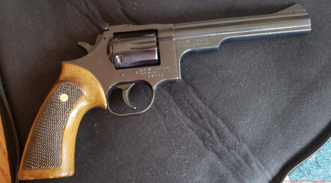

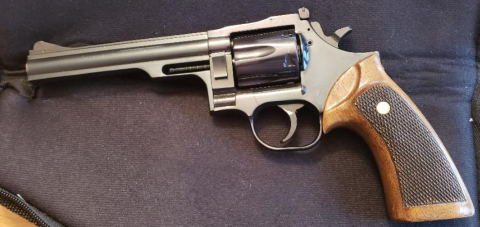

I just wanted to double check, this is a 15 pork chop target, right?
Plastic grip. There is a W in the emblem.
#42431 Can you help me get close on the production date?
Thanks
Trim-2-1.PNGImage Enlarger
Trim-3-1.PNGImage Enlarger
Forum Posts: 5437
January 1, 2019 - 5:01 pm
Correct.  'Powerwood' grip

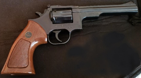

January 6, 2019 - 11:20 am
Walnut now. That's better.grip2.jpgImage Enlarger
Forum Posts: 5437
January 6, 2019 - 12:33 pm
ahhh, much better. Now, go 'choot it!
January 7, 2019 - 1:53 pm
Technically that is a model 15, but also called a Model 15-1 because of the smaller, High Standard style rear sight. The earlier 15 had the big rear sight of the model 12. The change from 15 to 15-1 happened at serial number 25,000. That would be 1972 or 73. The 15-1 is the same as the High Standard Sentinel MK iii.
   Not as attractive as the 15-2  the porkchops were just as accurate and the cylinder slides off when the shroud is off for easy cleaning.

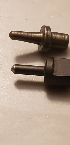

FYI - It has a model 12 firing pin in it and the spring is deformed.
And with the new FP spring, it needs more power so the 8 lb spring can't get it. I put the stock mainspring back in.
I can't seem to get the cylinder bushing to budge. Shake is minimal anyway. Face of what should be the bushing is somewhat uneven. Thinking it might be pressed in.
I might abandon efforts to lighten the trigger. I need to shoot some with the stock spring and see if I can get used to it.

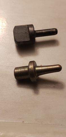

I didn't shoot the gun with the stock spring in as I was staring at the next gen firing pin and noticed the difference in the pin face profile:20190205_190149.jpgImage Enlarger
I found a new pin to mess with so I changed the profile on the face of the old style pin:
20190205_192357.jpgImage Enlarger
Kinda crude but it made a huge difference with the 8 lb spring. I will cycle us thru a box or two and make sure it is firing on all cylinders  🙂
