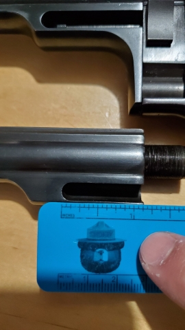

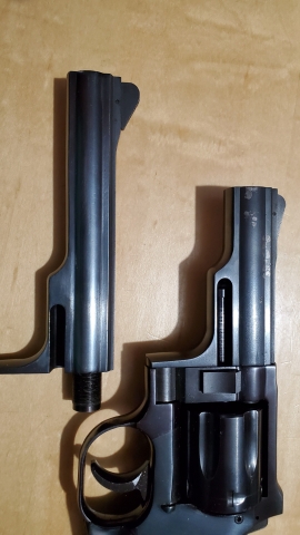

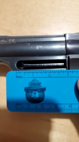

Anyone have any ideas?  See if I can load a pic from my phone.20200722_191538.jpgImage Enlarger
20200722_191624.jpgImage Enlarger
20200722_191648.jpgImage Enlarger

You sir have the same issue I had a while back. You have a 14-1, mostly the same as a 14-2 except the -2 is not a porkchop shroud. Your  6 inch barrel is from a 15 no dash hence the higher front sight and the short ejector rod slot. You can either try to find the early rod ( no button on the end and shorter), or you can open up the slot enough for the newer longer rod to fit. I looked for the short ejector rod and had no luck, so I opened the slot. You can buy a conversion front sight from EWK that should get you close or you can do what I did and cut down the tall sight to suit whatever load and range you like. Good luck to you, It's not that much work to do those things, and the results are worth the effort.

It affect both the 14-1 and the 15-1. On no dash 14, the rear sight is dove tailed into the frame. In the -1, it is a notch cut into the frame, making it lower and requiring a shorter front sight. On the 15s ( adjustable rear sight), the -1 has a shorter rear and therefore front sight. The ejector rod changed on both at the same time, same shroud just different front sight. I don't know exactly when this happened. I assume when the no dash changed to the -1 for both the 14s and 15s, but it could have been earlier.

Bob, you could shorten the ejector rod. Much easier. To have the milling done to the shroud and have it reblue would be money you would never recoup on a gun worth $450 at maximum. The Dan Wesson way would be to buy a 15  with a 33/4" barrel and have the first two Dans in your collection. Another possibility is to find the right ejector rod on eBay.

I had this issue with a High Standard.  As OleDog said the High Standards are equivalent to the DW 14-1 & 15-1   First thing I discovered is that there was apparently two styles of ejection rods.  One had a mushroom shaped head ( conical ) and the other had a round head. I actually possessed one of each.  I think I have seen some just knurled with no head at all.  I could be mistaken on the knurled variant.  I thought at the time that this was the issue as I was using a DW shroud on the High Standard.  I remain unsure if that was in fact the case.  However, the easy fix to gain the clearance needed was to simply add a couple of threads on the threaded end of the rod.  There is enough clearance where it threads into the ejection star to allow the rod the ability to thread just a tad more deeply into the star. This will give you the clearance you need between the shroud and the ejection rod end. The added threads are needed to allow this.  It does not take much to get the clearance you need. The rod as it is hits and stops threading into the star at the shoulder where the threads end.   If you simply shorten the rod it will still stop threading  at the same place . ( where the threads end ).  You would still have to use a die  to add a couple of threads.  No need to shorten the rod because  there is enough clearance for the rod to extend further into the threaded portion of the star assembly.  There was on mine.
