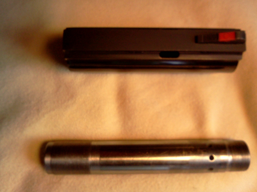

Maybe I have just missed the fact that 4 inch 44 mag Barrel Assemblies were originally ported? I just came into possession of the 4 inch BA below, with a ported shroud and barrel. I only thought the porting was only on 6 inch and 8 inch BAs (and maybe longer).
4" Ported 44 BAImage Enlarger

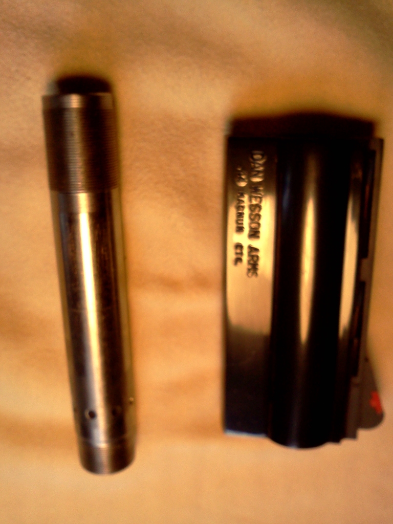

and the rollmark...
ported 4 inch 44 mag BAImage Enlarger
Are these common?  I think I may keep this one (but use my un-ported barrel)...
October 3, 2011 - 7:31 pm
Based on the articles I read most of the shrouds had the ports and you could get either ported or non-ported barrels.  I personally do not like the ported barrels and was fortunate to come across a non-ported 4" for my 744.

my 6 inch 44 has a ported shroud and non ported barrel

Ahh, my mistake. I like the un-ported BAs also, but I'd like the Monson Roll Mark to go along with the Monson frame I have.  So I will have to buy an un-ported barrel if am going to sell my etched un-ported shroud. Probably not a good idea to put a ported barrel in an un-ported shroud.
October 3, 2011 - 9:11 pm
Yes..bad bad idea wow

For my 744, except for the 10 inch shroud, all shrouds (4, 6, and 8 inch) are ported and I have both ported (which I don't shoot anymore) and non-ported barrels for each size.
This is a Monson made gun. I'm not sure whether Palmer made guns continued with this format and I'm pretty certain that Norwich guns were not ported.
Someone correct me if I'm wrong.
