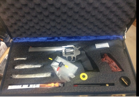

I have a 722 pistol pack 2.   It says first issue on the gold colored plate on the large blue fitted case. I read the threads here but the dates stop before Norwich manufacturing. The serial on the gun is A0017x. Any idea of manufacture date?

You have a very rare and wonderful gun. The Norwich First Edition  small frame guns are my favorite. The right side frame pins are polished smooth with the frame like most high end Revolvers. Colts and other DWs have rivet heads that look clunky. The First Edition stainless top strap and rail bead blasting looks like crushed diamonds. The First Editions were the first Revolvers made in Norwich but the serial number range varies for each caliber. Your gun was probably made in 2001. If you have extra barrel assemblies that came with the pack they should all have the same First Edition number. Any BAs not purchased with the pack will not have the First Edition design and number. After the First Editions the frame pins were not polished off and the shrouds were not numbered. The A stands for 22 caliber whether it is 22LR or 22Mag.

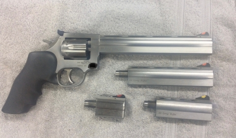

I tried to put pictures up, but it would not let me. Maybe I do not have enough posts to be allowed to post pictures.
edit: i figured it out.
razerface
Forum Posts: 24
October 17, 2023
October 18, 2023 - 9:22 am
IMG_4715.jpegImage Enlarger
IMG_4716.jpegImage Enlarger
IMG_4718.jpegImage Enlarger

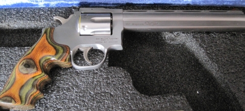

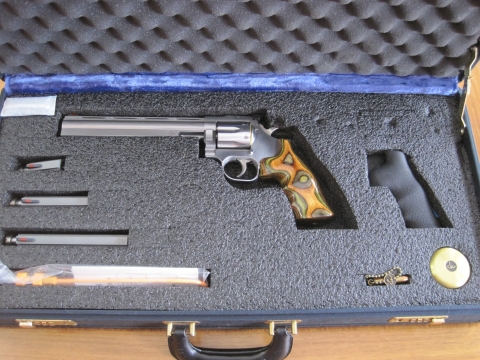

I am not sure about the frame as you blocked the serial number but those are not the correct barrels for a First Issue 722 Pistol Pack II.   Here are a few pictures of my First Issue 715 Pistol Paclk II.  Notice the barrels are all roll marked first issue with the last three digits of the revolver. My First Issue Pistol Pack II was manufactured in 2002. Yours is still a very nice looking 722 Pack though.

Serial on frame is A00172. Are you sure all the pistol pack 2s were marked like that?
Forum Posts: 1697
October 18, 2023 - 9:50 am
Yes, all the barrels for a First Issue Pistol Pack II were roll marked First Issue and the last three digits of the serial number. Those are not the correct barrels for a First Issue 722 Pistol Pack II as all the barrels should read First Issue 172 in the case of your revolver.  It is still a very nice Pack though.  I will let Ole Dog confirm for you as he has lots of knowledge regarding Dan Wesson but I am pretty sure.
razerface
Forum Posts: 24
October 17, 2023
October 18, 2023 - 10:08 am
So it is a “put together” pistol pack?
Forum Posts: 1697
October 18, 2023 - 10:09 am
Let Ole Dog confirm but I am pretty sure the barrels are not correct.
October 18, 2023 - 1:30 pm
Yes, not a First Issue. The case is though. The First Issue insignia and number  would be on the right of the frame under the grip if it is a First Issue frame. It appears to be a First Issue as the frame pins on the right side are polished flush with the frame. The 21/2" BA is probably an EWK. There is no roll mark or vent rib.
razerface
Forum Posts: 24
October 17, 2023
October 18, 2023 - 5:16 pm
I will take the grips off to check. The 2-1/2 barrel does have roll mark the same as the others,,,bad pic by me. I notice DAs short barrel also has no vent in the rib so maybe the short ones did not have that feature?

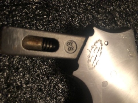

The roll mark is there on the frame, but no number
IMG_1535.jpegImage Enlarger
October 18, 2023 - 6:15 pm
Very observant of you about DAs 21/2" BA. So, the case and frame are probably original but somewhere along the way the BAs were sold and the other Norwich BAs acquired. Still a nice pack.

Ole Dog can chime in but I was told very few of these packs were ever made Pistol Pack II First Issues.  Pretty rare I was lucky to get this one I felt.  I had two like the one I pictured but sold one to a collector friend of mine.  Why someone would sell the matching barrels to a First Issue makes no sense as they are serialized to the revolver itself.

Under the grip, it is marked First Issue.  The first 400 of a run I believe are First Issue, mine was 138.  But like I mentioned even though the serial number is 138 I was told maybe only 27 of these packs were ever manufactured and put together as Pistol Pack II's.
