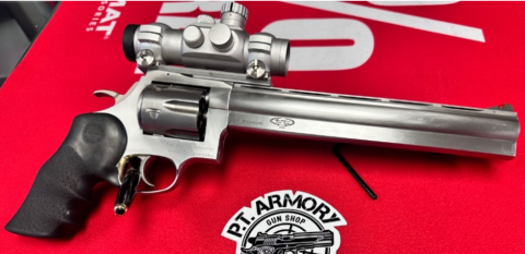

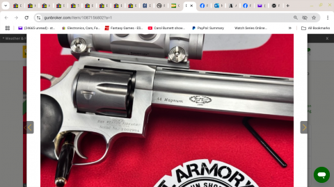

I threw a very low bid on this Dan Wesson First Issue 44 magnum with a 10VH barrel. It has a small scope on it mounted with a screw and also using the rear site spot to anchor. First, I can't believe I got it for $1035 and $30 shipping no CC fees. I did not really want it since I figured the shroud is tapped and drilled but never did I think it was going to sell for that! Anyway I guess I can go 2 ways. One take the small scope off, plug the hole and put a rear site back on the gun or second I was thinking of buying a Burris scope (stainless) and trying to find a Dan Wesson factory style scope mount and put a Burris scope on it like it was mounted at the factory! I know I would have to drill another hole to do it and then it would be a hunter pac look a like. Just an idea it's like putting a coyote engine in a 67 mustang! LOL  I did look and I can get a older style Burris 2X pistol scope  for $160 or less. Screenshot-2025-02-03-3.07.15-AM.pngImage Enlarger

That scope is the reason it didn't bring a lot.  I think they drilled the top strap of the frame too.  Even if they didn't, being a First Issue, the numbered shroud preclude matching it with another.  I had a low bid on it too, but that scope turned me off on it.  I have the same gun with no scope so I didn't 'need' it.
Had i got it, I was going to put a scope on it that I have laying around.

Pull the scope off and plug the holes.  Use the correct screw plugs (6-48)>>
https://www.brownells.com/tools-cleaning/general-gunsmith-tools/shop-supplies/plug-screw-kit/?sku=080716961
You can bead blast the screws to match the top strap or barrel rib and they look fine.  Make sure you use the "Positive Stop" screws to plug the holes.

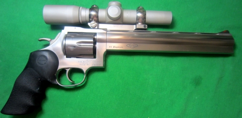

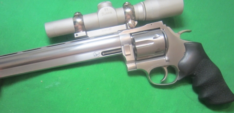

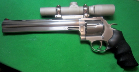

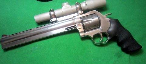

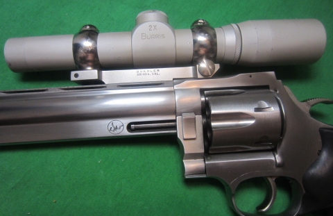

I got the 44 magnum 10VH barrel First Issue back from my FFL/Gunsmith and I think it came out pretty good! I bought a Burris Eye Relief scope and got this one from Kurt (Thx) it looks pretty close to a stock one that was used many years ago. My gunsmith did a great job re-drilling the shroud to accept the mount in the correct place. I was going for a gun that looks like the person ordered it from the factory with a scope. The only thing I think may look better is the scope rings I would like to change them from chrome to a brushed aluminum look to match the shroud a bit better but over all I think it came out pretty nice! What do you think? Click pic to see bigger or click twice opens new window for a even bigger pic!IMG_7484.JPGImage Enlarger

Keep the steel and bead blast them to closer match the scope.   It should look like the top rib of the shroud when done.
