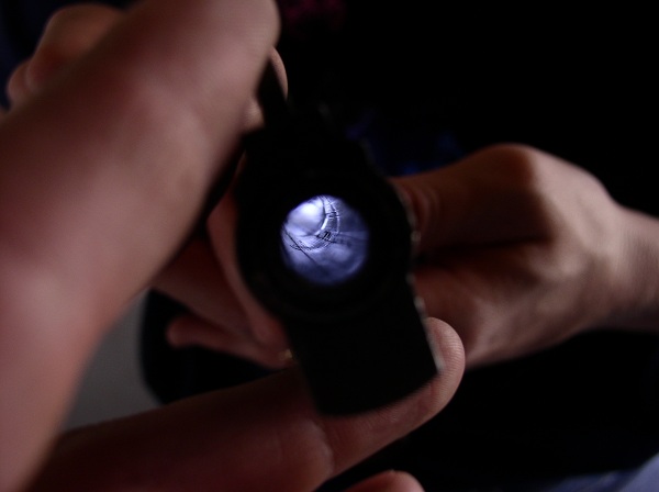

Anyway, they informed me that they had taken it shooting and there seemed to be something stuck in the barrel. I looked and they were shooting Winchester White box 125gr hollow points. I regularly used these at practice, they were very nice rounds, pretty hot, very accurate with a fantastic sound and an awesome muzzle flash…
This is what was in the barrel.

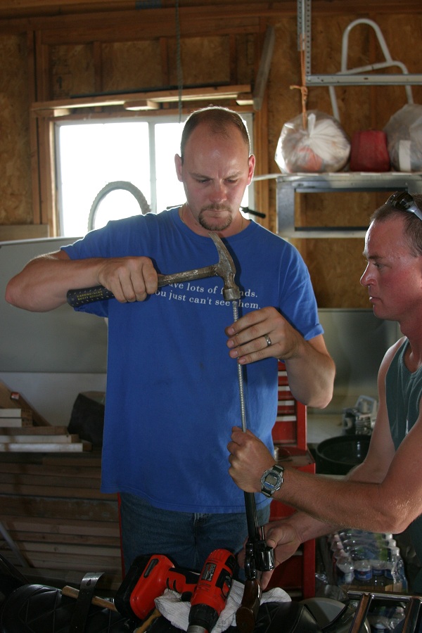

This is what we did next….
I think you can see where this is going….

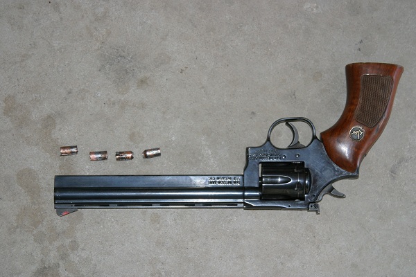

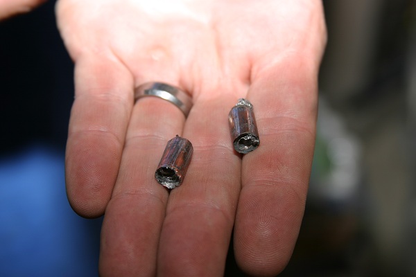

We not only pulled two bullets out, we pulled out FOUR.
The only thing I can figure is that they had a squib, and that the subsequent three rounds stacked up behind the first WITHOUT the barrel exploding and seriously maiming everyone around….that's pretty impressive. They were dang lucky they were shooting a high quality handgun and not some cheap piece of junk, or I'd be picking my daughter up at the emergency room at best…

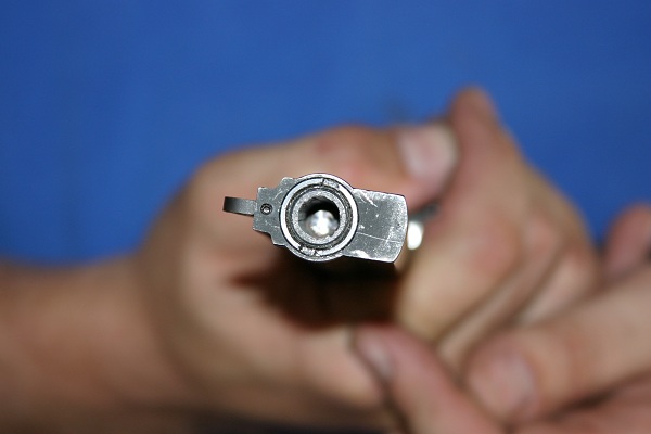

Here's what the barrel looked like….
You can clearly see that the barrel did bulge with each round, there are two that you can't see in the picture…it's amazing it held together at all.
