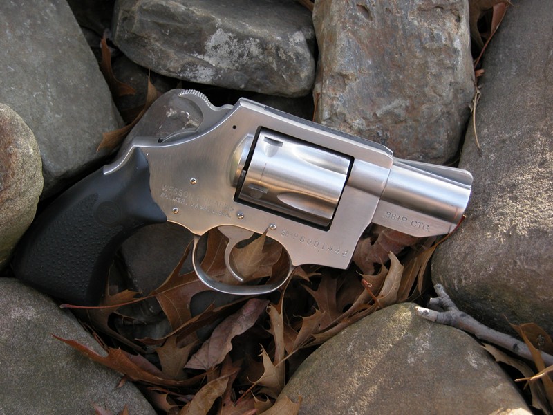

I will throw one more fact at you that will muddy the waters.  Between 1993 and 1995 Dan Wesson produced the model 738P (aka Lil' Dan) which had a slightly smaller frame than the Small Frames.  This gun only held 5 rounds of 38+P and was offered with a 2" barrel.

I will throw one more fact at you that will muddy the waters.  Between 1993 and 1995 Dan Wesson produced the model 738P (aka Lil' Dan) which had a slightly smaller frame than the Small Frames.  This gun only held 5 rounds of 38+P and was offered with a 2″ barrel.
Man I sure would love to run across a good buy on one of those guns. Big Grin

As overbuilt as the "Lil Dan" is, its a shame they didn't just chamber it in .357mag.

I was kind of wondering the same thing, from just the picture. I always thought that DW's looked "over built" and specially the 22/722 models, but the "Lil' Dan" just looks like a tank.
