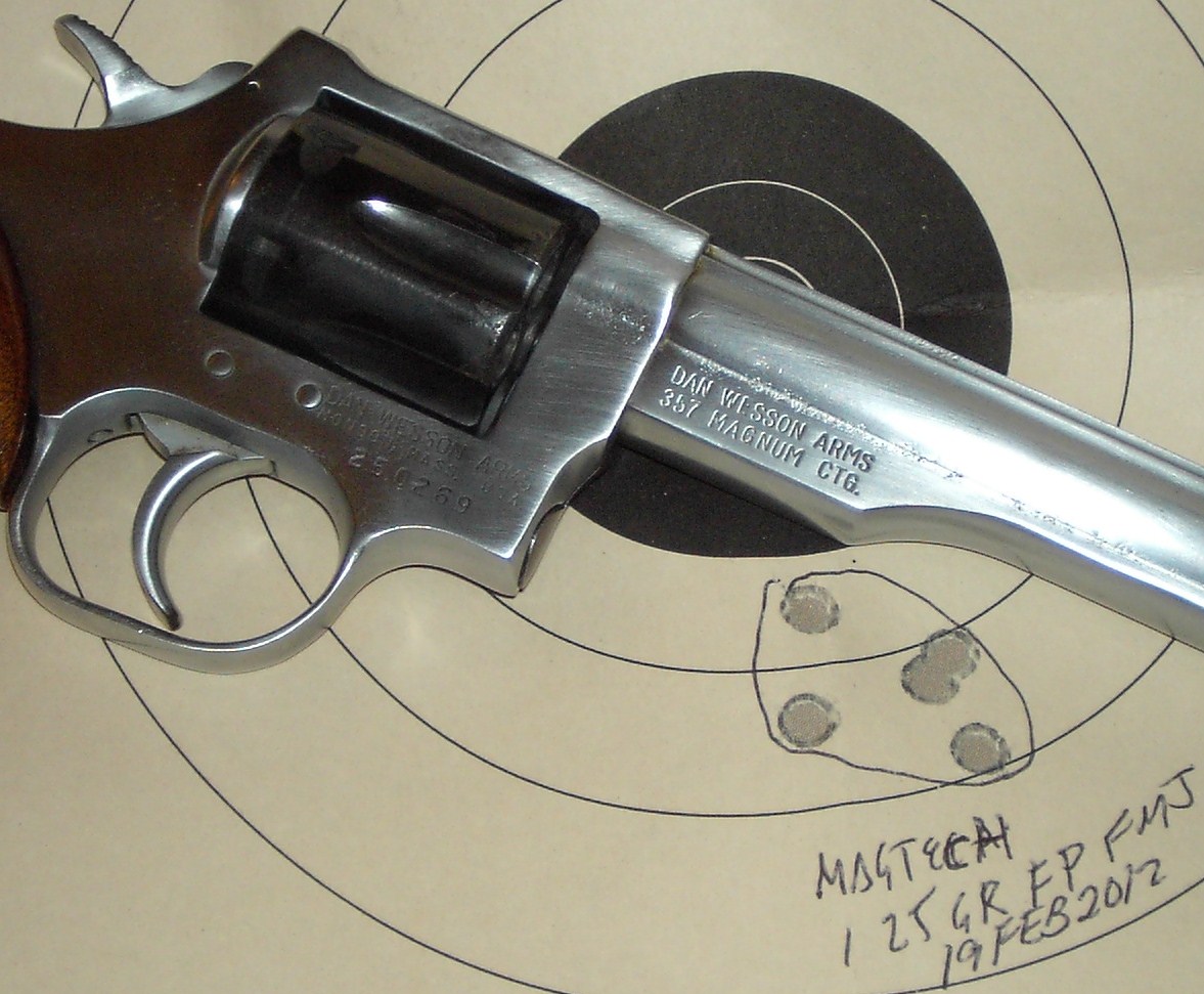

Did a range check today on the 714 with the replacement blued steel cylinder assembly.  My main concern was accuracy and functionality of the combination before investing the bigger dollars to make the changeover to 9 mil happen.  This was a make-or-break moment.  If something was wrong, I would abort the project and count my $50 dollars spend on the new cylinder as a learning lesson.  But if it turns out the accuracy is reasonable enough to proceed with the change, I will do it.  Here is a picture of five rounds of 125 grain Magtech 38 Special FN pumped through the "palomino gun:"
It turns out the group using a two handed hold at around 6 yards was fine.  I know if I had "benched' the 714, I would have tighter groups.  So, a little over an inch in a clustered grouping using a two hand hold was accurate enough for me.  The verdict? Proceed with the 9mm Dan Wesson conversion. Stay tuned.
