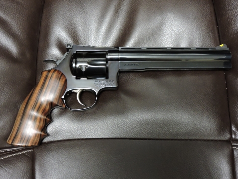

Hello All,
              This my first Dan Wesson and I need help on where to find things I will need to work on this firearm since all I bought was the gun. Please help point me in the right direction as far as tools, sights, grips etc. Thanks in advance. Boats
DSCN4896.JPGImage Enlarger
Fair Winds and Following Seas
October 31, 2019 - 10:49 am
Dude, that is gorgeous !!! drool
That is a Large Frame revolver, so go to the Gunsmithing section, where there are some tutorials to help you become familiar with it.
https://www.danwessonforum.com/forum/reloading/large-frame-disassembly-tutorial-pics/
https://www.danwessonforum.com/forum/reloading/large-frame-assembly-tip/
The first things you will need is a barrel nut tool and gap tool, that is required to disassemble and reassemble the shroud and barrel tube. The sights are just fine for now and so is the grip, unless it is uncomfortable or unwieldy.

October 31, 2019 - 12:16 pm
Thanks for the info!

October 31, 2019 - 3:32 pm
A 44 mag barrel tool will work fine on a 45.  A 45 tool is made of unobtainium. You can set the gap to  .002. Always take your barrel tool with you when you go shooting.

October 31, 2019 - 4:31 pm
Thanks for the information. I found a 45 colt tool on a website but he wanted 130 dollars for it.

November 1, 2019 - 7:33 am
EWK has the large frame barrel tool listed for $28 but currently OOS. They also sell a larger pilot for 45 cal. You might want to contact them about when they'll be available again. Beautiful 45 you bought!

November 1, 2019 - 10:18 am
Thanks. I made contact with Dan Wesson and bought a barrel tool from them. I think it cost 43 plus 12 shipping.
