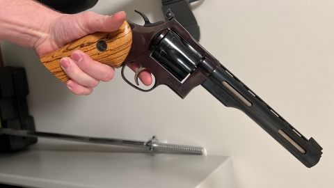

December 10, 2023 - 6:55 pm
060860C7-D529-4ADE-92C1-76B01116DB26.jpegImage Enlarger
KurtB said
occasionCongratulations on your score!! 😆
Thanks! It’s an awesome gun 🙂

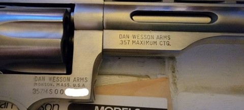

March 9, 2024 - 7:25 pm
unspellable said
What seems to have been forgotten over time is that the 357 Maximum and the 357 SuperMag were two different cartridges.  The DW was chambered for the SuperMag as was the Seville.  Early DW 357 SuperMags were marked as chambered for 357 SuperMag and 357 Maximum both.
And WOW! So, I have a .357 Maximum because that is what is says on the barrel shroud (& serial number is 357MS00xxxx)  VS.  if it was a Super Mag it would say .357 Super Mag on the barrel shroud (& serial number would have been 357SMS00xxxx)?? All for .005 of an inch??  (and 10K extra pressure)
Also, the head stamp will/must read 357 MAX or Sup Mag as appropriate?? Have to double check as I know I have Remington Max brass... will have to double check for SM stamping.
20240309_174650.jpgImage Enlarger
March 9, 2024 - 8:30 pm
I have both and older and newer Model 40 and 740 and they are all chambered for the 357 supermag. They will all chamber the 357 maximum.  That .005 difference is insignificant.  The trim lengths of most brass is a few thousandths less the max case length.  I recently had to make brass for the 375 supermag, (Yes I typed 375) and the trim length stated for the case was 1.60 even though it has a max case length of 1.610 as all supermags do.  That's a .010 difference.
It's unlikely you'll find much 357 Supermag head stamped brass, but there is plenty of 357 Max brass out there.  Load and enjoy.
Also remember, the same supermag frame you're shooting 357 max/supermag from is the very same one that is safely handling 445 supermag.  So the 357 SM is the baby of the supermag guns all based on the same frame.
