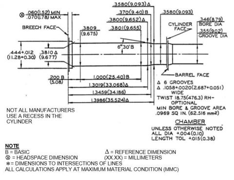

My 715 throats are .358"(-)pin gauges, the 15-2 is .358(+) pin gauges.
Maybe a PO had the throats honed/ reamed to create more of the 'funnel' affect from throat to forcing cone to bore?  Seems a bit excessive though, maybe they DIY-ed it and got carried away?
Bump your bullet to .3605" and see what happens.  If you can't bump up, beagle your mould so it drops a fatter projectile.  That cylinder may only be good for the j-word bullets.
.358" in a .360" throat is no Bueno...
Spec for bore is .355", throats at .3580"; both +,- .004"
357Mag-Chamber.JPGImage Enlarger
