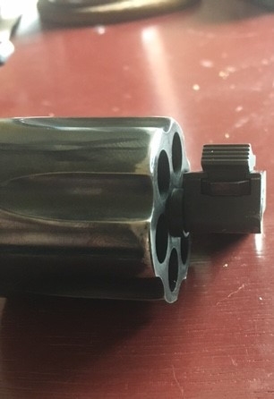

Hello everyone,
I am having a bit of trouble getting my Model 15's cylinder to release from the crane.  I have been trying to give the revolver a very thorough cleaning as it was filled with gunk and I cannot get the cylinder to release from the crane. The ejector rod and ejector star come out fine, but the small bearing the cylinder revolves around and the spring inside the cylinder just will not release.  Worse yet, the cylinder will no longer rotate as it seems to bind and lock the gun up. IMG_2606-1.jpg
Have any of you experienced this and if so, how did you resolve it?
Thanks for helping me out.

Gunk, gunk, it’s likely just gunk. Good old Hoppes 9 or Break Free will eventually get the job done. Be patient. Let it soak for a day or two then gently tap with a plastic mallet if needed. If that fails a gunsmith may be needed. Good luck!

Kroil and time.  If you want to heat up the metal, use a paint stripping type heat gun.  That will allow the metal to expand and contract, helping the Kroil to creep and eventually allowing you to get them apart.
March 5, 2021 - 12:56 am
I will sometimes use my ultrasonic cleaner with Simple Green HD (purple colour) well diluted, high heat, and 40 minutes.  Takes gunk off all my Harley parts, too.  Safe on aluminum parts as well.

You might try some good quality penetrating oil.  NOT WD-40!  I use  PB Blaster.  It is a good penetrant that uses oil to lubricate as it cuts the gunk and rust.
Good luck.

Thanks for all the responses!  I really appreciate it.  Eventually, I got it free from the old grease, oil, dirt, and crap that had congealed under there.  I used an old C&R trick of wrapping the part in a plastic bag and leaving it sit on the dash of a car under direct sunlight.  Even with the winter sun, I managed to loosen it and wiggle it free with a bit of finagling.  I am definitely going to get some Kroil to have on hand next time!   Got it apart and all cleaned now.  I really appreciate all the help and suggestions!
