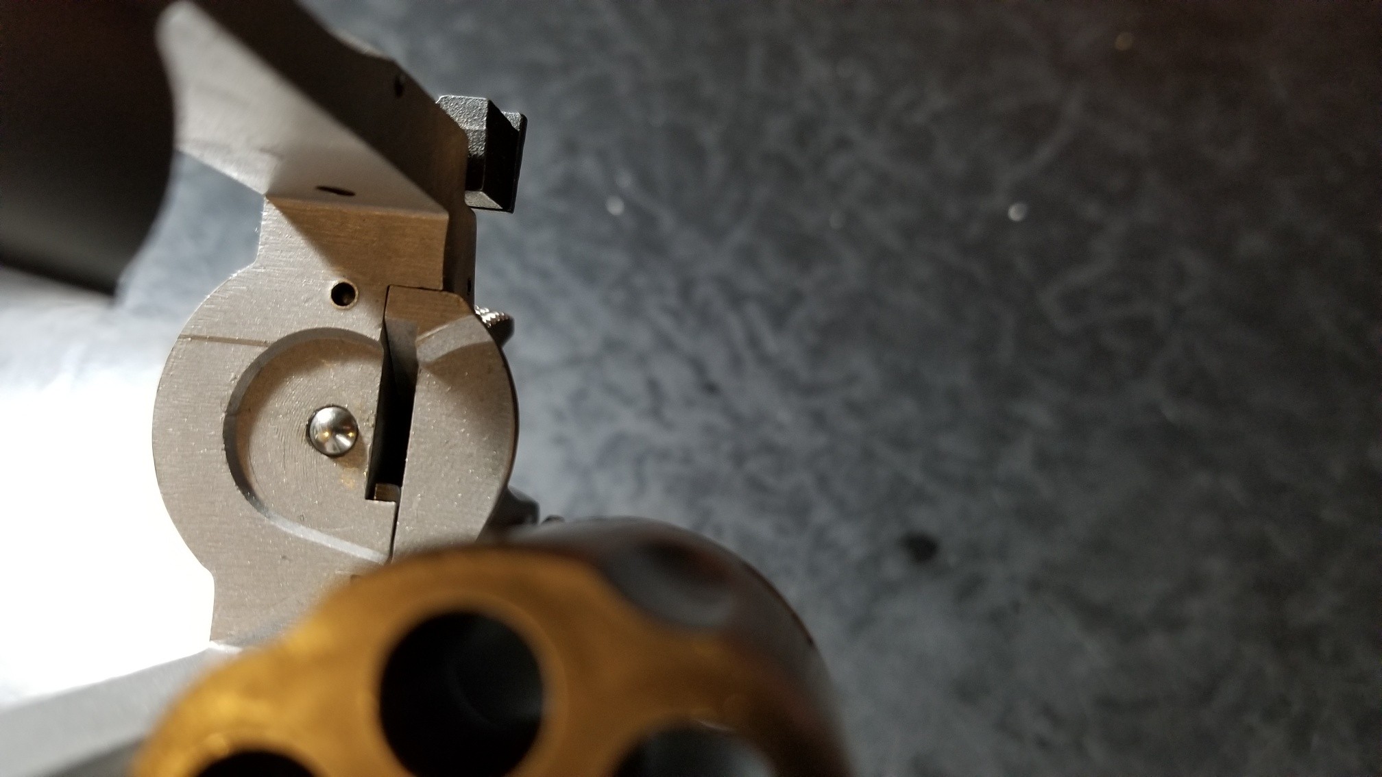

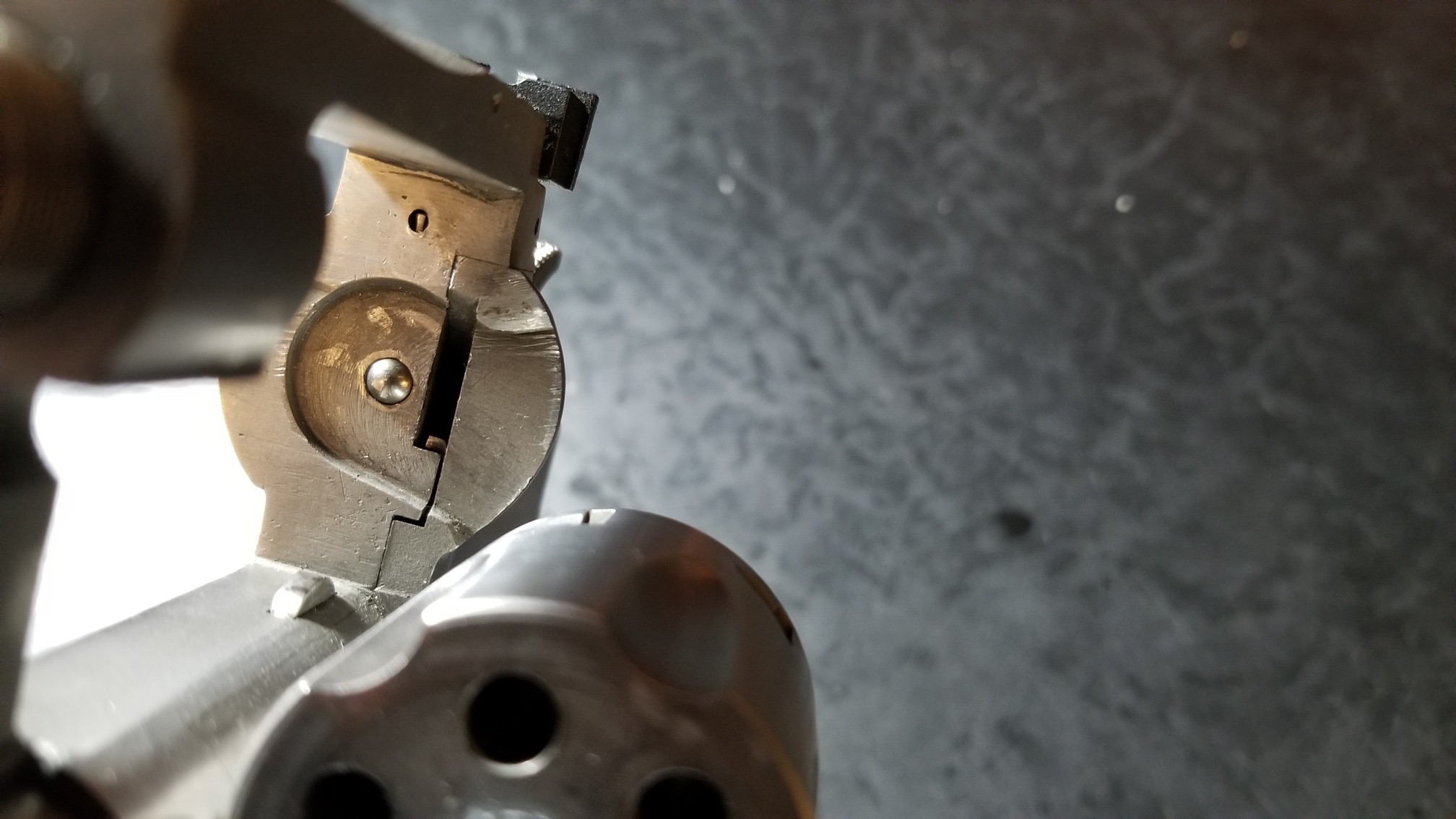

January 1, 2019 - 9:13 pm
I stand corrected on the firing pin...they are different.  The .22 is a blade-type pin and the center fire is a pin-type, however, they are in fact located at different positions in the frame.  Attached is a .22 and .32. If you bored everything on centers I'm not sure where the firing pin will hit.  What about the extractor....what are you doing with that?

January 2, 2019 - 10:03 am
The extractor was reamed with the cylinder.
I put a fired case in the frame/cylinder and pulled the trigger. The case has a hit between the side of the primer pocket and the primer. It did strike the edge of the primer so it may be close?
