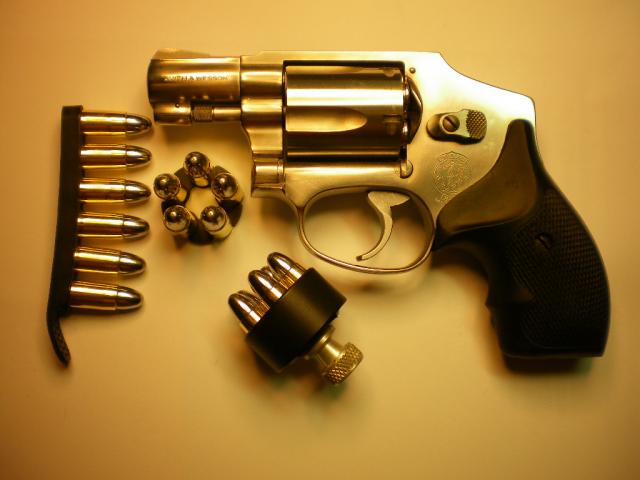

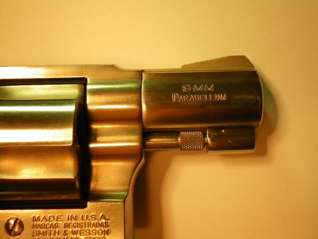

I have a Smith and Wesson J-frame 940 chambered in 9mm.
Smith-940-Jframe-9mm.jpgImage Enlarger
Smith-940.jpgImage Enlarger
I typically use 9mm moon clips with it, but sometimes I will hand load auto rim rounds just for the 940.
You just don't see that many of these around anymore, and I really like J-frames quite a bit.
