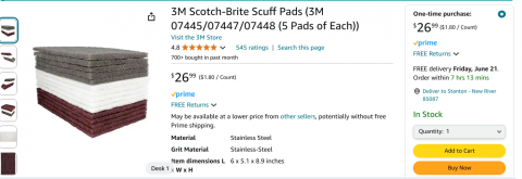

Scotch-bright works very well. Here is a pac with 3 different types from course to fine. Deeper scratches use course and work up to the fine. Lighter just use white. I did use a bit of WD-40 on the pad. I do know some members use wet/dry sand paper on deeper scratches. I never had to use them. The Scotch-bright pads made my barrels look great! The white and grey pads are hard to find but this multi pac on Amazon is a good deal!Screenshot-2024-06-18-4.46.13-PM.pngImage Enlarger

Yes, Stan is correct, use the various Scotch Brite pads to work the scratches out.  Will be as good as new!
