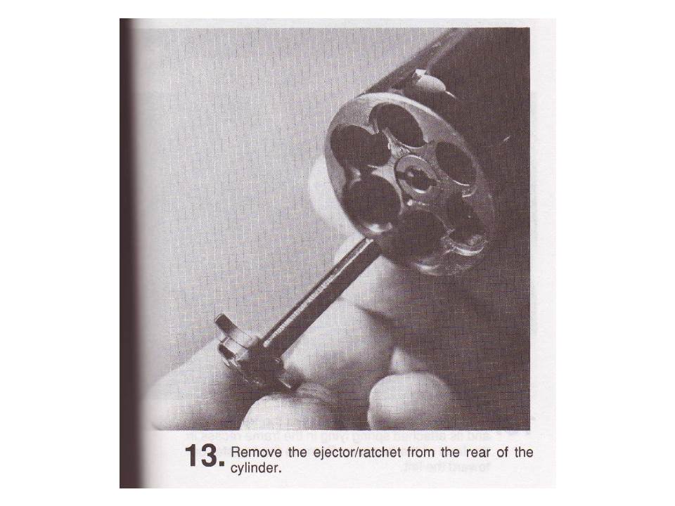

Can not reassemble cylinder properly? It won't fit back into the frame.

Make sure the stars trac bushing is down at least flush. I do not know if it is pressed or threaded, tho, it does have a pin.
Here's some more photos of the star and the track bushing.
I kinda feel there is a more than desirable amount of the track bushing protruding from the cylinder - it is not flush. How is this adjusted? I don't know how to get a pin like that out, but assume it takes a specialized tool.

Only that it still is one... Trying to channel the DW gods for some help! I'm in PA, not far from Norwich, so that might be a final option. Surprised this hasn't happened to someone before! I am really perplexed as to what exactly went wrong. I mean, I was following the AJT for disassembly and reassembly, and all I did was put 50 rounds of .38special 158 grain through.
extraction was very sticky, however. I hope I did not cause this problem by jamming down on the extractor arm too hard, although it is looking as though this may be the case.

pull the cylinder back apart-- roll the ejector rod across a flat surface and make sure it is not bent.  If it is straight, screw it into the star and spin it by hand to see if it looks straight.  Something is not lined up properly.

mtwtrf - not sure if I'm helping just throwing things out, but I guess I'll keep at it until something shows up that helps.  Does the back of the cylinder under the extractor look like this pic?  Not sure but it looks like maybe there's a bushing threaded in there, maybe it's not seated all the way keeping the extractor from sitting fully flush?Rear-of-cylinder.jpgImage Enlarger
There is indeed an extractor track bushing held in with a roll pin. I was able to use a wooden punch to get it lowered a bit. I realize now that I was pushing the busing out toward of the back of the cylinder when I was forcibly removing those spent cartridges at the range. I was really whacking on it and maybe it moved more easily because it was warmed up. Thanks to Cecil too for the advice to look at this component.
So now the cylinder closes, the arm meets with the star and cycles as it should BUT I am back to square one, meaning my initial problem of the trigger sticking once every six pulls has returned, and I am positive it is just on this one chamber. I went back and reread my initial thread about the trigger sticking and double checked the trigger overtravel screw and the grip screw (although I don't have a washer in there, I don't believe this is the problem).
So I am in better shape than a week ago, but still lost as to why the trigger would stick once every 6 pulls, and this is with or without the barrel and shroud installed to rule out a proud chamber at the face of the cylinder. My thoughts: maybe I need to seat the star track bushing down a tiny bit further in case once of the chambers is proud on the rear of the cylinder? I have tried but can't seem to get it to go any further, however I wasn't using the exact proper tools. I can get my hands on those this week.
Another thing I notice is that when cocking the hammer to advance to the chamber that has the trigger-sticking issue, it feels like there is a hard catch on the second half of the cocking motion. Then I squeeze the trigger and it sticks. Same chamber every time. Could this be a worn out star or cylinder hand, or perhaps they are not mated to each other?
