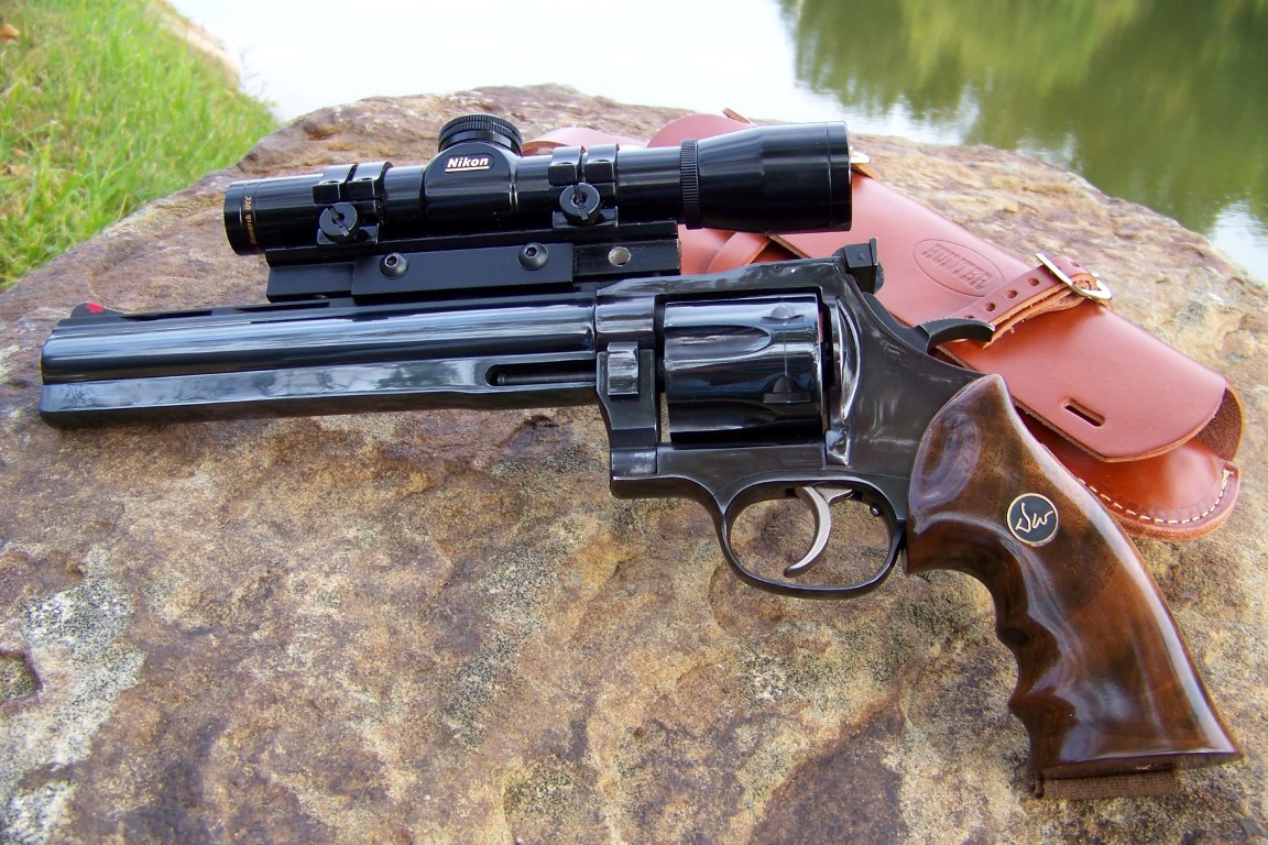

    Or you could use this type mount. No drill , common base easy to find.

    Blacktop, more info please like brand, model number. Will it fit the Dan Wesson 744SS?    Thanks for you info.

    That is the B Square mount that was also pictured in the scope mounts topic. They are often available on ebay auctions, one just sold on our DWF Fundraiser Auction a couple of days ago.

    What's that "extra hole" (?) at the back of the B-Square mount? I don't see that on mine.
    Pete, I think the B-Square fits a 357 and 44 (can anybody confirm that? I have mine on a 357). I can bring mine along when we get together so you can "try it on".  I want to keep mine, but you can  see if you want to go that route.

    I bought a super-mag with a B-Square mounted, so yes they work on large frames also. asumming there is only one model of mount that is.
    Umm...only one I own..didn't know it was an extra hole. Got it and some other goody's
    last year.

    The extra hole is to adjust the base more forward, and I've had one on my 357SM for several years and it's still tight.Welcome
