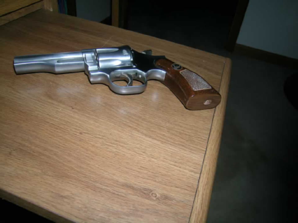

Stopped in gun shop in s.carolina today I have bought guns from him before
asked him ifhe had any dan wesson's he said yes 2 in back of store somewhere.He brought out a stainless 357 looked like new no box or tools had 4" barrel replaceable it was made in monson 4 didgit ser number.I didn't have replaceable front sight and rear sight lookedlike a halfmoon recess no  sight any kind.HEsaid he would take $400.00for it as soon as he said that 2 other guys at the counter said to him they wanted tolook at it so I made deal quick andhe put gun away.Where can I find model number?I won'thave gun for 2 weeks he has to send to dealer in nc I will post pictures when I get it. samedealerhas 4 boxes 357max ammo remington he wants to sell

From your description, it is a model 714.  The remaining part of the model designation would depend on the barrel shroud version.  If the standard shroud, the full model would be a 714V4.  With a heavy shroud, the model is 714VH4.

I agree, sounds like a 714. Here's a shot of a rear sight you're describing from a 14 (blued version).
Although, as far as I know, the 14 & 714 models only had one shroud style. The top rib is ½ as tall as the 15 & 715 shrouds, so no vents are optional on these. Various DW shroud types can be seen HERE.

Thanks for help.How hard is it to find vented,slotted heavy shroud for this gun.Can you retro fit a adjustable rear sight tothis gun?

You would have to get a gunsmith to machine the frame & fit an adjustable rear sight to it. You can mount 15-2 barrel assemblies on the 14, but if you stay with the fixed rear sight, you would need to get a short front sight from EWK Arms (the link to the right of this screen)-->
15-2 BA's can be easily found on Gunbroker.

Vented, slotted, heavy shroud for a small frame would be a very custom item. Basically you would need a VH shroud, get the slots machined, and install the EWK Conversion front sight.

Yep, what Steve said. I didn't catch the slotted word in there this morning.embarassed

March 11, 2011 - 9:46 pm
jaggman
Emmaus, PA
Forum Posts: 1358
May 17, 2009
March 11, 2011 - 11:24 pm
Looks pretty nice. Thanks for the cool-pics
March 12, 2011 - 12:18 am
Uhmm...seems one of the members tinkered around and slotted
a BA...now who was that wink
